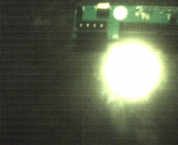

You're not alone with this. I once had the same issue as you. I found out that a flashlight (a pocket lamp) can be helpful here:
Hold it under the PCB and you'll see all traces clearly! Then, just keep looking for short circuits. They are usally near the connectors or chips..
The last SATA /IDE converter I used was okay, though. I bought it for my old Mac and it worked. It was one of the "one way" models, without a switch.
It simply attaches to the SATA HDD. But I can't say whether this is a good model or not, 'cause I'm a newbie at this, afterall. The chip's name is JM20330.
I also attached two pix for you, maybe they can be helpful (sorry for the bad quality 🙁 ).

    IDE/SATA converter (front)
