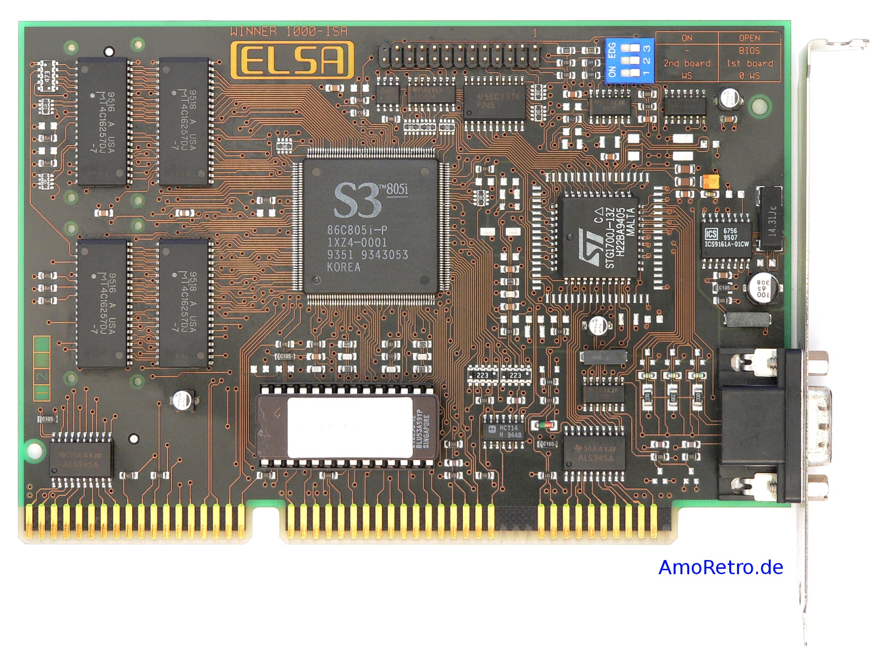

I'd sure like to see some DOOM benchmarks between the GD5434 and 805i on the same system, preferably with an SXL CPU. When do you think you could run this? Do you have a photo of the S3 805i ISA?

I suggest if you want to see an ISA based S3 805i, just google ELSA Winner 1000ISA. As far as I know, it's the only 805i ISA out there.
Doom benchmarks appeared to be identical with the 805i and the 5434 when I tested. I suspect the ELSA has far better output quality than the Diamond.
This card is also available with a 16-bit RAMDAC. My card is equipped with that one. And by that, I mean it supports 16-bit transfers, not 16-bit colour. Even 8-bit RAMDACs can support true colour.

The GD5434 has an integrated RAMDAC. I'm not yet sure how this compares with the discrete one used by the S3. I would think their capabilities are quite similar. I will have to look up the datasheet on the RAMDAC that is included on my card. It says "ATT20C409". The GD5434 is also 64-bit, while the S3 805i is 32-bit, but using memory interleaving. Neither of those technologies seem to have much effect on DOS performance though. The S3 may have a slight edge over the CL in terms of compatibility, and the CL might have a slight edge in terms of Windows performance, but I think they are both quite good.
