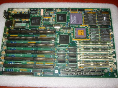

I did a quick search and I'm now pretty confident that the OPTI 391 chipset is "write back" L2 only so L2 caching scheme shouldn't affect BIOS compatibility between motherboards with this chipset as all boards should be "WB".
The "WT" version of the chipset seems to be called OPTI 381 as seen on this motherboard.
OPTI 381 386 "WT" motherboard. The picture is "stolen" from an Ebay auction. If you own this picture and want me to remove it just send me a message.
468.31 KiB
1229 views
