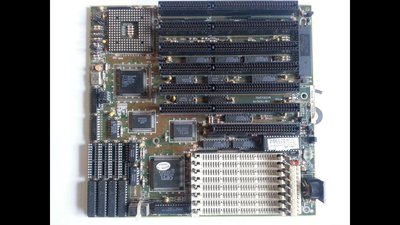

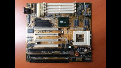

Reply 81 of 287, by Radical Vision
Then this board is good, bcuz when i did show it, at least 4 people did tell me it is good is from ASUS, but the chipset is total trash..
But good to hear other things, as the board is in really good condition , like brand new..
Not only chipsets, back in that era many brands did die, or changed direction to other type of products..
BTW your ultimate 386 link is broken, fix it, i was interesting to see the ultimate 386 build...

Radical Vision wrote:
Yeah i did saw it on my first look for it, but was not sure if that is the correct board..
Interesting to see the chipsets are SIS, that chipset brand is considered from many to be bad and not worthy..
The SiS Rabbit, SiS 471, and SiS 496 are generally well liked among 386/ISA, 486/VLB, and 486/PCI motherboards, respectively. I didn't really follow SiS much after that, though I've heard that the SiS-based socktet 4 board is faster than the intel-based counterpart. I did find the SiS 460 (ISA 386/486) to be disappointing performance wise.

Reply 90 of 287, by Radical Vision
That damn boards does not want to post, but i have only x6 SIMM memory sticks, so i hope it is from the need of all slots to be filled with memory..
I have other 386 board with OPTI chipset and the board want all 4 slots to have memory on them in order to post, so i guess then that is the thing here..

Reply 91 of 287, by feipoa
I was under the impression that all 386 boards can only use 4 or 8 modules, and nothing in between.
Reply 92 of 287, by Radical Vision
Well the damn board wont post with 4 modules, or 2 modules or 6 modules, i did just try to see if it will post but nothing...
As my other OPTI board want all slots to be filled with memory (4 on the board) and then it will post, while with 2 sticks nothing..
But i don`t have more then 6 sticks of SIMM for now, so i can`t fill all 8 slots in order to see if this is the deal like on the smaller OPTI board i hope so, as the CPU is AMD DX...

Reply 93 of 287, by gdjacobs
Aren't there some freak boards that break that rule?
Reply 99 of 287, by Anonymous Coward
There are a few 386 boards that take FPM (not EDO) 72-pin SIMMs. Most of them are either PS/2s or OEM machines. I've seen a few relatively standard 386s with that configuration though. I don't know that there's any advantage of going that route unless it's difficult to get 4MB density 30-pin SIMMs.
There is one very small form factory 386 board I've seen that has four 30-pin SIMM slots and a single 72-pin SIMM slot. Supposedly it can go up to 128MB of DRAM, but unfortunately it only has 128kb cache, so you can only cache 16MB in writeback mode.
