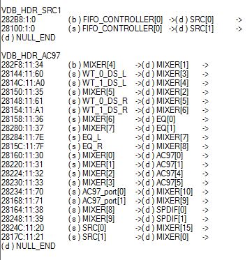

archsan wrote:
Thanks for clarifying. Has this been done in any of the official drivers?
Not that I've seen, the list looks like this in the card: (Taken from my debug control panel)
52.13 KiB
1139 views
See how the WaveTable (WT) left channel access transfers are second and third in the list? These should be pushed down in the chain so that WaveTable isn't touched until after the fourth todo link.
No biggie, it's not like it gives "that" much performance increase all in all.
It's a simple fix but the current Aureal drivers will overwrite the changes whenever a new sound is playing.
