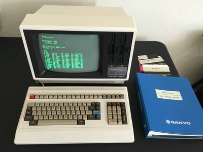

This was found in an old warehouse in West Texas, still boxed, very much yellowed. Finished product came out well.

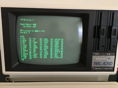

It's primarily a CP/M machine but it also runs DOS 2.1. I' am kind of curious as to what type of games may have been played on this type of system.

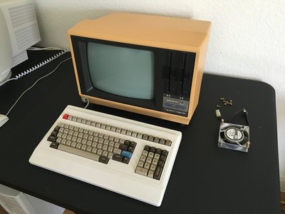

Reply 2 of 3, by 133MHz
How did you get such a good retrobrighting on the case? No streaks as far as I can see! 😳 How did you protect the labels?
http://133FSB.wordpress.com
Reply 3 of 3, by Formulator
Yes, the case was too far yellowed for a retrobright treatment. Probably would have turned pink, and the surface was too smooth. I have only had retrobright success with haircell or other textured surfaces. This case required a vinyl dye treatment, in which I eventually decided on the shade "Wimbledon White." I used Frog Tape to protect the labels.
