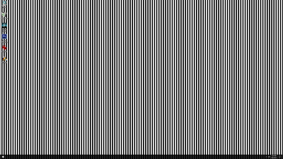

Reply 36 of 53, by oeuvre
Hey s0ren thanks for the new wallpaper!
    39.85 KiB
    592 views
