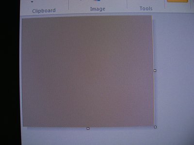

I uploaded one here http://imgur.com/spi12OC never mind the camera interference pattern - the horizontal blurring of the black lines is what bothers me. The total width in pixels of the entire image is correct when using 1600*1200 in forced 4:3, but there is some interpolation or something going on anyway, as you can see most of the white stripes are not actually white. Instead of b/w/b/w/b/w... it goes light grey/medium grey/light grey/black/white/dark grey and so on. On the mouse pointer i can also see that there is a tiny amount of blurring around the edges, but i didnt take a photo of it.
Im not accusing you guys of being blind or something btw 😀 There must be a technical reason for the differences we are seeing, i just dont know what it is. When were your monitors produced? It could be that a recent-ish firmware has a different interpolation algorithm or changed the forced scale functionality somehow. I tried with newer nvidia and intel GPUs using both VGA and DVI in Windows 8 and 10 by the way. You all use the forced aspect ratio mode selected via the monitor OSD right?

You really need to create a proper 1600 x 1200 image with 1px wide lines for this to test properly.

I've done that an the pattern is like the one on the photo. Only every 5th white stripe is actually white - the others are grey.

By Dell, not me 😉 The test image doesnt have to be full screen, the interpolation issue is obviously not only occurring on the 274x230 square i by chance placed the mspaint window in on that photo.

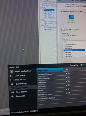

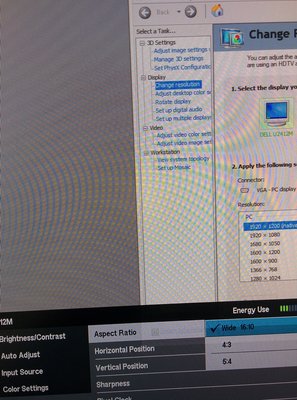

Reply 49 of 53, by s0ren
Uploaded more photos to show that not all U2412M are the same 😀
    3.05 MiB
    420 views
    1920x1200
    4.14 MiB
    420 views
    1600x1200

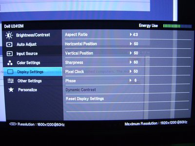

    2.82 MiB
    366 views

Imperious wrote:
At the bottom of Your 2nd image it says 1920x1200, which is the current resolution the monitor is set to. When You run a lower r […]
At the bottom of Your 2nd image it says 1920x1200, which is the current resolution the monitor is set to. When You run a lower resolution on these
monitors than the maximum it shows the current resolution on the left, and the maximum on the right.
For whatever reason Your monitor is 1920x1200 instead of 1600x1200 and that is most likely the problem here.
Thanks!! That solved the mystery. The problem was that the NVidia settings changed the output to 1600*1200 with no scaling as it should, but in the Intel GPU settings it was apparently configured to stretch the output to 1920*1200. The image was thus first stretched on the computer and then squeezed on the monitor, causing the quality to degrade.
