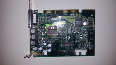

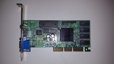

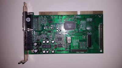

Amongst other things, items of interest for such a build were an Opti 16 ISA (cant see a brand) sound card, a DSAC-300 (HP Digitan systems) ISA sound card, sweex 5.1 PCI sound card, Aureon Fun 5.1 PCI a Rage 128 pro, a Voodoo 3 2000 PCI, various SDRAM, another Socket 370 motherboard with a Celeron installed, some IDE DVD roms, Some IDE HDDS from 2GB to 250GB, IDE cables, Floppys drives. oh and a ATI AllinWonder 7200 AGP, various old nics.

Anyway I took the system home and took no time in stripping and cleaning everything, I then replaced the coin cell in the Gigabyte motherboard installed along with the Rage 128 pro (after Phil's review), and went for a test boot.... Nothing, Nooo.. I thought crap its knackered. I replaced the ram with a single 128 stick and tried again, still nothing. I then re-seated the processor and put the ram in a different dim.... and

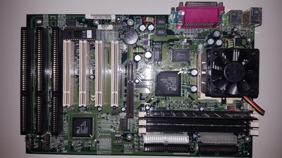

Looking at the ZIF socket it read socket 7, yes... Fecking Socket Phils Computer Lab Sodding Seven!(Could it be Super???) I took the heat sink off.. oh I thought a heat spreader on the processor what can you be? I cleaned the stale compound off and read K6-2 400???
At this point it was getting late and I actually got in bed but had to tell my Girl Friend I wouldn't be able to sleep not knowing if the board worked or not, so I got up and striped the Pentium board out the case, installed the newly found board with a stick of 128 ram, the Rage 128 Pro and coin cell out of the Pentium board.
Crossing my fingers I pressed the power button, my monitor changed resolution and then the magic moment POST! I turned it all off not wanting to tempt fate (Remember no heat Sink fan) and got in bed with a nice smile on my face wondering how the hell I now had this motherboard and what a K6-2 400 was.
Since finding the board I have found a fan that fits the heat Sink and soldered a 3 pin plug on, cleaned and installed . The 2 GB drive must of been from the system as when I tried it with this board it booted to Windows 98 SE with a desktop background of one of my first cars and Alien vs Predator installed but not much else (ok a couple of pic of naked ladies from dial up days), I just don't remember ever using it 🤣 and when I did it must of only been for a brief period.
OK so nice story you thinking but why post it of this Forum? Well there's is not much in the way of branding on the board so im thinking its OEM, im really hoping someone might know more about this MYSTERY MOTHERBOARD... and also give me some advice on the sound cards I have, I've tried the Opti and have got sound out of it but its very noisy in term of electrical noise.
The other ISA sound card the DSAC-300 detects and installs but I cant get audio out of the speakers under 98, there is what looks like an onboard opamp on board and a aux_pwr floppy connector so Im wonder if if have to supply power to the card?

If it turns on and you can see things, you can check the ID string at the bottom of the first screen to google the model. Take a look at this site's "BIOS Method" http://www.dannychesnut.com/Recording/Compute … Motherboard.htm. They also mention tags on the ISA slot, but I tend to just jump right to firing up the machine and googling the ID.
Reply 3 of 14, by Nipedley
It looks a lot like the BCM VP1543, check out the link. They even still have BIOS updates available to download http://www.bcmcom.com/tech/VP1543/VP1543.htm
Congrats on finding the board! Be careful though, this hobby is addictive. I started out building a Pentium 4, and now I have a Pentium 3, a 486, and an itch for something new
Also a note on your sound cards, for most DOS games you will want a card that has OPL3 and SoundBlaster compatibility (SB, SB Pro or SB16 depending on the games you want to play) I'm not sure what either of those two cards you mentioned are compatible with. Personally I use the Yamaha Audician 32 Plus which has real OPL3 and SB Pro compatibility, in both my 486 and Pentium 3. They're also super easy to find, even brand new, and cheap

OMG Nipedley, you are like a motherboard detective, how the heck did you find that from just picture, I couldn't find a thing! thanks you.
It looks very very similar I will look for some more hi res picture to compare.

Thanks for the advice on the sound card, I will post a pic of the Opti as well, and have a look at the Yamaha. Whats funny is my dad has a Yamaha MU80 attached to his Clavinova Piano , which ive seen used to play general midi through for games (another Phils Computer Lab Vid) so I was wondering what card I need to use it and have a play.

There's one on eBay with a hi-res picture, also extremely expensive. Actually I just googled the chipset (ALI M1541) and 3 ISA and socket 7 and it was one of the first ones that came up 😀 It sure looks like your board

Okay apparently your Opti is Sound Blaster Pro compatible (same as the cards I'm using), so it should be pretty suitable for DOS.
One thing you can try to reduce the noise is JP5 and JP6 on the card, it's printed that JP5 and JP6 being jumpered 1-2 is SPK OUT and 2-3 is LINE OUT, changing this changes the amount of amplification. I had to change this on my Yamaha as there was a large amount of noise/hiss with the amplification enabled.
P.S there's a good driver resource for your card available here on Vogons driver library http://www.vogonsdrivers.com/getfile.php?fileid=628

What do you think about the DSAC-300? Also ive just seen your card it has two large FM chips will the Opti card be able to reproduce FM (if that's the right wording)?
Thanks
Reply 14 of 14, by Nipedley
I haven't been able to find much on the DSAC-300, apparently it's also Sound Blaster Pro compatible though.
I found the datasheet for the Opti 82c931 ftp://ftp.alsa-project.org/pub/manuals/opti/82c931.pdf which seems to indicate it has Opti's own OPL3 emulation and FM, so should be fully compatible with any SoundBlaster/Pro games. If the sound quality is okay with those two jumpers changed over it sounds like it might be a good card to try out.
The cards that emulate the OPL3 and cards with a real OPL3 (some SoundBlasters, and the Yamaha Audician) sound a little different sometimes, but it's down to personal preference really. If it works and you like the sound of it then I'd stick with it
