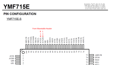

CD, FM, Voice... all the sources were reversed? His cable was reversed.
To me it seems that SBPro2.0 has everything alright, no need to switch cables or reverse stereo.
One thing is wrong with the YMF71x, the Wavetable analog audio is actually reversed.
EDIT: I've checked the PCB and Datasheet and indeed, the traces from the wavetable go into the wrong inputs on the YMF chip.
It's MOD time.. 😎

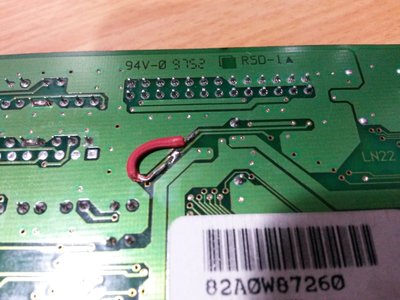

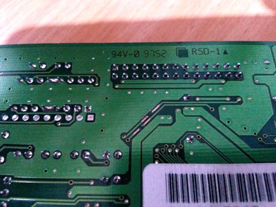

Reply 137 of 215, by James-F
Wavetable Reversed Stereo FIX
The Audician 32 has the Wavetable audio return reversed in the PCB itself where the Left channel from the wavetable header goes into AUX2R on the YMF71x chip and vice versa.
Since it is an easy fix I decided to take things into my own hands.
77.41 KiB
4560 views
345.13 KiB
4560 views
345.42 KiB
4560 views
351.65 KiB
4560 views
By no means my prettiest job for the lack of proper green trace fix wire, but it is functional and durable.
The channels in the Mixer did not change, only the input from the wavetable.
The first guitar in Doom E1L1 is on the right channel now, as it should.
Side note: The Left channel of the CD cable is the WHITE wire, it goes to pin 1 as marked on the PCB.
Now the Audician 32 is even more better... 😎
