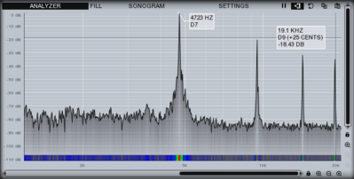

There are definitely frequencies beyond 16kHz (32kHz sampling rate) in the SC-55 MKII.
A simple experiment with a high pitch note and some reed instrument clearly shows a higher harmonics beyond 16kHz.
If the DAC sinc filter was at 16kHz then there would be noting beyond, but it is not.
The harmonics in the spectrum analyzer are actually part of the note and not an artifact, distortion or aliasing.
* The red line on the frequency ruler marks 16khz.
45.21 KiB
1287 views

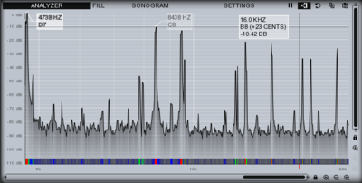

Here is D10 note on Percussive Organ:
42.18 KiB
1278 views

@James-F: The frequencies above 16kHz are just mirroring and noise. The JVs have this too, even though the DACs are clearly running at 32kHz. Take a look here: http://www.donsolaris.com/?p=404

I was wrong, the SC-55 MKII DACs indeed run at 18bit 32kHz.
As in the article Romantique Tp linked, the filter after the DAC is not as good as todays sinc brickwall filters.
So some frequencies go beyond 16kHz but they are not necessarily aliasing, they can be part of the note.
