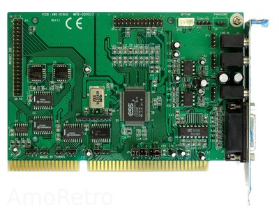

Reply 2 of 21, by squareguy
This is the card.
443.05 KiB
1104 views
The gain is a little high but it was designed to power unamplified speakers and it has no line out. This is not an issue, just a note. I think replacing the two power amps with an op amp (with lower gain) and using it strictly as line out could reduce noise. It wasn't noisy listening through speakers but I haven't had a chance to listen through headphones. The computer is at my shop and my headphones are at home. I am seeking more of these to have as spares / other computers.
If anyone has manuals please let me know. All I found was the ES1688 chip datasheet. I like having manuals even if not needed.

First, congratulations, this is a great SBPro clone card.
Let no one tell you the ESFM (OPL) sucks because it is MUCH more faithful to the OPL3 than Creative CQM or other clones, so much so that without a direct comparison it is indistinguishable.
Get this driver:
https://www.vogonsdrivers.com/getfile.php?fil … 616&menustate=0
ESSCFG.EXE /M:E /B:330 to enable MPU-401.
ESSVOL.EXE /V:7 W:8 /S:5 /A:8 for balanced sound.
W = Voice.
S = FM Synth (OPL).
A = Wavetable return, 0 if you don't use one.
The Lowpass filter on the ESS1688 sounds great, it behaves exactly like the SB16.
One downside is when the MPU-401 is Enabled I can hear loud "PC think noises".
But if you look at it was a SBPro it shouldn't have a MPU-401 anyway... So use another card for MPU-401.
leileilol wrote:
Does this exhibit the same half-Hz behavior resulting in lower quality PCM sound under DOS? I remember an integrated ESS1688 doing just that, causing 22khz to become 11khz, 11khz to become 5.5khz etc.
This happens after the card is switched to high-speed DMA (Stereo) mode of the SBPro, not only with the ESS card but ALL SBPro cards.
Games that use this mode for Stereo like Duke Nukem 3D will leave the card in this mode when you quit, so other games will sound like they are playing in half the sampling rate.
DOSBox does too, if you set it to SBPro as your sound card.
Use this small soft by Jepael to fix this and switch the mixer back to normal (mono) mode and bring the sampling rate back to normal.
Sound Blaster Pro stereo bug

Reply 8 of 21, by FGB
Hi squareguy,
I don't know if it was you who bought the card in my eBay shop or if you are just using the picture from my listing. But I'm happy you like the card. To me, the ESFM synth does a great job, especially in the OPL3 / 4OP mode.
But in games with the "Miles" sound drivers library one can actually use the enhanced features of the ESFM synth. In "Z" by Bitmap brothers for example. It sound quite better than the normal OPL3.
ESS based cards are underestimated IMO, I think mainly because many of them were cheap generic cards. But actually there are a lot of good cards with a clean Line-Output.
Cheers,
Fabian

Reply 9 of 21, by squareguy
Fabian,
It was yours 😀 Now it's mine 😉
I assumed, like others I suppose, that ESS was inferior. I was wrong.
