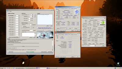

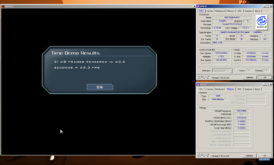

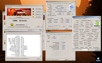

Reply 10 of 14, by Standard Def Steve
If you want the absolute fastest Tualatin system, you'll need a motherboard based on the Apollo Pro 266T. This chipset easily outperforms i815 and smashes its 512MB RAM limit. And if you're made of money, dual CPU Pro266T motherboards are available as well. 😀
I have single-proc Pro266T system and am very happy with it. It's stable and works very well with relatively modern hardware. Unlike the older Apollo133/694T chipsets, it's completely stable running graphics cards at 4x AGP. It's set up with a:
-QDI Advance 12T motherboard
-PIII-S @ 1575
-2GB PC3200 @ 300MHz/2-2-2-6
-evga 6800GT
-XFi XtremeMusic
-XP SP3

Crysis @ 800x600 Low DX9 preset:
787.14 KiB
5000 views
3DMark 2001SE:
342.66 KiB
5000 views
