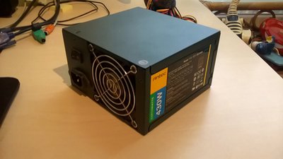

Reply 1 of 17, by brostenen
I am really happy with my Antech 430W. Pretty shure it is an "Antech Eartwatts (or something) 430W".
Only thing that is missing, is -5volt rail, so it is in my Socket 370 without any ISA slots.
