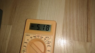

I am currently investigating the possibility, to add negative 5 volt to an ATX psu, discussing this with Keropi at the moment.
Currently, we have looked into a couple of possible solutions. The one I am going by at the moment, is in the picture posted.
The motivation is to be able to use the homemade device in conjunction with something like a modern 500watt PSU.
(Look at the idea/buildingplan for it, like an early 2016 X-Mass gift for everyone)
I will not say what it is just yet. Though the plan is to provide everyone with a building plan, if this is a succes in the end.
Untill now, I have spent a total of 0.99 US Dollars. The total price for a DIY project will be a little higher.
Right now it is jumping from -5.12v to -5.18v wich is not bad, compared to a voltage monitor, found in an ATX board BIOS.

    Small teaser!!! :-)

Minor setback.... Blew something.... 🤣

I have seen that online somewere too... The problem now, is that I can get -5volt output, the problem is to choose wich gnd I need to connect alongside the -5volt line. If I measure directly on my converter, it is spitting out -5volt. I connect the white wire to the -5v terminal. Choosing any of the black wires will draw too much through the converter I am using. It did survive. I thought I blew it because it is getting too hot. Still working though.

All I can say, is that I can convert +12v to -5v and draw up to 3 amp.
(that amp is acording to the spec's from the seller)
The thing I bought, might not deliver the kind of amp what it say it should.
Though being able to convert +12 to -5, makes me think I am on the right path.

That is a l7905acv. According to what I can find online, it used negative 12 volt and not positive 12 volt as input.
As -12v rails do not provide enough milliamp, I really need to be able to draw somewhat 500 milliamp from positive 12volt.
I guess the ISA slot solution is a simple one, taken directly from the datasheet. Looks like that. 1xregulator and 2xcap's.
Going for the regulator solution, there must be a simple solution to reverse polarity using off the shelf parts.
Once converted 12 volt positive to 12 volt negative directly, something like a 7905 regulator can be used.

Most AT power supplies had 0.3A max output from -5V anyway, and -12V outputs at about 0.5A to 0.8A.
How much would anyone need -5V for sound cards, 100mA or 200mA tops maybe?
The 7905 in TO220 case generating -5V from -12V would be perfect for that job, as long as it has ceramic bypass caps, some bulk electrolytics and enough dummy load to keep its output stable.
If you want to generate -5V from +12V, +5V, or +3.3V, you need either inverting switch mode voltage regulator or inverting flying capacitor charge pump, both of which are more noisy than linear regulators.

as I said earlier, use a LM337 to feed the 7905 to get -5v. the LM331 will give you the negative voltage, which the 7905 will make an exact -5v.
or if you dont want to feed the 7905,
an lm337 with +12V input using 2 resistors of 240ohm + 720ohm will give -5v output.
http://ibration.headcrank.com/LM337Calc.php?Vout=-5&R1=240

It won't work because LM337 can't make positive input to negative output.
It is just an adjustable regulator that can be directly used to get -5V from -12V with correct adjust resistors, so it would be simpler to use just 7905.
