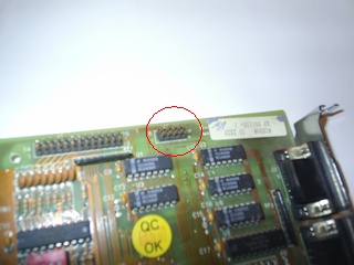

Reply 3 of 11, by Jo22
Is the wiring for that rs232 port alright ?
You know, some i/o cards do use a small header to connect to a cable w/ db9 plug.
Sometimes its pinout is non-standard or you have to flip the plug to make it work.
Sorry, I'm not very good at explaining things, I'm afraid. 😅
I've attached a picture for you.

Reply 4 of 11, by orinoko
Hmm, I ran into a similar problem a while back on a 486 board...
Basically the COM port was wired in such a way that the DB-9 connector was wrong.
I've found that it can either be:
1,2,3,4,5,
6,7,8,9
or
1,3,5,7,9
2,4,6,8
I think...
I could be totally wrong though.
Reply 5 of 11, by Jo22
Me, too. I've got an old internet box which is wired weird.. 😕
1=1,2=2,3=3,..
