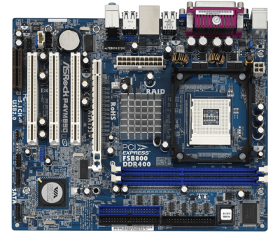

Reply 24 of 41, by Carlos S. M.
The ASRock P4VM890 R2.0, VIA based PCI-e Socket 478 i also have in my collection
711.64 KiB
915 views
ASRock P4VM890 R2.0
Specs:
CPU: Pentium 4, Celeron and Celeron D (Willamette, Northwood, Prescott)
FSB Speed: 400/533/800 MHz
Chipset: VIA P4M890 + VT8237R+
RAM: 2 GB RAM max, DDR 266/333/400, Single channel
LAN: VIA Rhine VT6103 PHY 10/100
Audio: Realtek ALC653 AC97
Video: Onboard VIA UniChrome Pro (DirectX 7.0 support, no T&L)
Slots: PCI-e x16, 3x PCI
IDE ports: 2x ATA-133 (from VT8237R+)
SATA ports: 2x SATA 150
OS Support: Windows 98/ME/NT 4 (no IGP driver)/2000/XP/Vista (no IGP WDDM driver)/7 (no IGP WDDM driver)
Comments:
No as good as the P4i945GC, but still interesting at some point, board supports Windows 98/ME and maybe possible to run NT 4 at some point, no idea if the PCI-e port shares the same issues as the 775dual-vsta and the 4coredual series (can't run GPUs past Fermi/pre GCN)

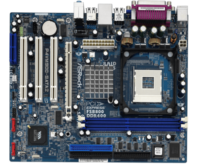

Reply 25 of 41, by Carlos S. M.
The ASRock P4VM900-SATA2, VIA based PCI-e Socket 478, also own this one and is an updated version of the P4VM890 R2.0 with newer chipset
665.66 KiB
908 views
Specs:
Chipset: VIA P4M900 + VT8237S
Audio: Realtek ALC660VD HDA
Video: Onboard VIA Chrome 9 HC (DirectX 9.0 support, SM2.0 unknown status about T&L and HW Vertex Shader, need to verify)
IDE ports: 2x ATA-133 (from VT8237S)
SATA ports: 2x SATA II
OS Support: Windows 2000/XP/Vista/7 (not officially supported)
Comments:
Updated P4VM890 witth VIA P4M900 chipset, drops Windows 9x support, gets new IGP with WDDM DirectX 9 cappable GPU, but i heard is extremenly weak, even slower than the dreaded GMA 900/950, i need to futher test the board and verify the IGP features, also gets a newer southbridge with SATA II ports and replaces AC97 with HDA for the onboard audio
