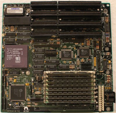

On a 486 mainboard I removed a leaky battery which was close to the keyboard connector. I seems to work but the keyboard does not work.
The visible traces are ok but I can't find any connection to the keyboard controller.
The 40 pin dip ic of which I assume it's the keyboard controller is labelled with:

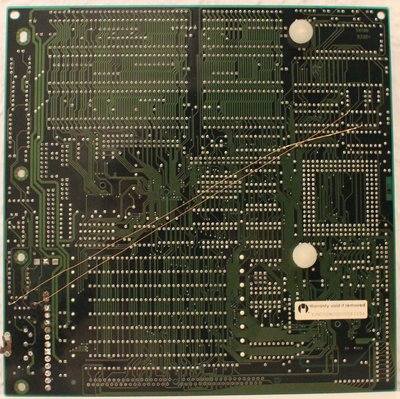

Problem solved 😀

The MEGATRENDS MEGA-KB-H-WP uses the same configuration and a 7406 next to it.
Both copper traces for keyboard clock and data seem to be damaged, probably close to where the cmos battery was.
The mainboard is a octek hippo com EP40085R21-198 REV 2.1 with a Am486DX-40:

Here's the quick fix:
2.41 MiB
2037 views
Maybe this is useful for someone else too
Reply 2 of 4, by Anonymous Coward
What a strange board. Why does it waste so many slots?
Reply 3 of 4, by devius
Probably because of the onboard IDE, floppy and I/O controllers. I guess they hadn't integrated these into any chipsets then, and the board is too small to have the necessary extra circuitry and keep all the slots.
