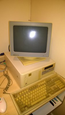

I recently acquired a complete 286 PC.
Specs are:
  • Intel 286 12 MHz
  • 1.5 MB RAM
  • Hedaka HED-986 motherboard (http://arvutimuuseum.ee/th99/m/E-H/30430.htm) - the previous owner had the old barrel battery removed and replaced it with an external battery (so, no acid damage).
  • 1.2 MB floppy & 1.44 MB floppy disk drivers (the latter is definitely a late addition)
  • 20 MB Conner hard drive (CP3024)
  • MDA graphics card
  • 16-bit IDE controller
  • 180W PSU (this one still has a switch on the side of the case).
  • 12" B&W Monochrome monitor
Here's a picture of the PC:
339.2 KiB
1374 views
286 12 MHz PC

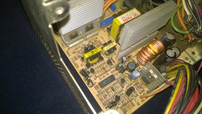

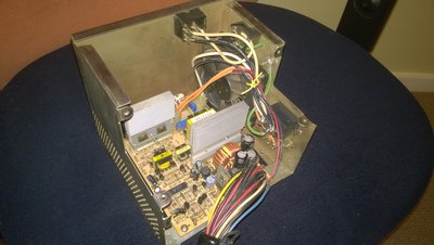

Some pictures of the PSU after I had opened it up.
First picture is the PSU on its side - the switch is on the top.
1.99 MiB
1290 views
PSU - Pic01
The two capacitors on the right hand side seems a bit bloated. Maybe I should start there and perhaps just replace all three of these. It appears they "bonded" these as well with some glue (which has now gone brown over the years) - you can notice it at the bottom of the capacitor furthest to the right.

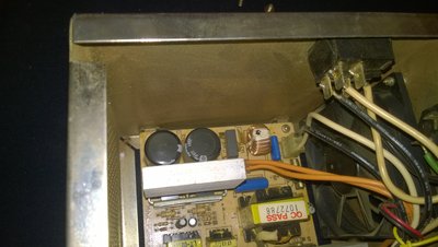

PSU - Pic02
Since I'm not an electronics expert, I have no idea what these two black circular objects are (also some type of capacitor?). However, the one on the left appears to be quite bloated, compared to the one on the right.

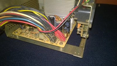

PSU - Pic03
No obvious faults on this pic

Reply 6 of 12, by jade_angel
jesolo wrote:
Some pictures of the PSU after I had opened it up. […]
Yes, the two black objects are electrolytic capacitors, and they look farkled to me. Probably want to go ahead and replace all of them.

Reply 9 of 12, by kenrouholo
is the LT-13 transformer as messed up as it looks to me?
Not sure on those caps from that angle. I see goo but it could be electrolyte or it could be glue. In any case, with their age, I wouldn't trust them especially on an old PSU,

Reply 11 of 12, by TELVM
All or most of the smaller caps are Rubycons, that's why this PSU is still alive @ 2017.
The three larger PCE-TURs close to the yellow 'donut' coil are probably busted, from a distance they look like two 10V 2200uF on +5V and one taller 16V 2200uF on +12V. Also replacing the two bulk caps ('Nitsuko'?) wouldn't harm.
