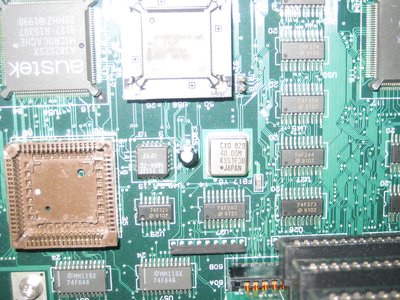

I have a packard bell 386 machine that has a 386 chip that looks like it is socketed. I have never messed with a chip like this and thought I would ask before I tried to remove it from the mainboard. I would like to put a 33Mhz DX chip in there as it is currently a sx-20.

Reply 1 of 12, by gdjacobs
Please take a photo of the clock gen to the right. Some motherboards don't have a pll and require a different crystal to change clocks.

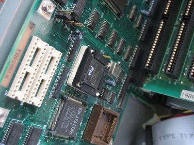

Reply 3 of 12, by lowlytech
Hal, do you know any other info on this board? Like what kind of cache ram I am assuming goes in those two 28 pin sockets? I vaugly remember another post here on the forum where someone put the wrong cache in and it smoked and blew up.
gdjacobs, here is the pic of the generator I think you wanted. The fact that it is 40MHz pretty much gives it away that we are stuck at 20MHz I assume?

Reply 4 of 12, by Anonymous Coward
This is a really awesome setup. You have a removable 386SX CPU and cache. I've never seen them together like that. Please show more photos. Can the motherboard be adapted for other cases?
Reply 5 of 12, by gdjacobs
Crystals can be replaced, so theoretically 25mhz is possible on this CPU assuming the ISA bus doesn't clock synchronously and explode.

Does anyone know where I could possibly get documentation for this board? I would love to know what the jumpers do, and what my options are for adding cache. I assume those two chips near the front of the board with the -25 are cache, and the -80 is the video ram.
You are right. The board has 16KB cache. I guess the two empty sockets are for another two 8K x 8bit SRAM chips.
