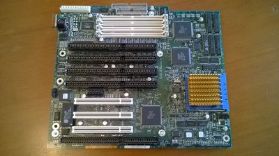

Can you help me find a manual or at least a board name of this motherboard? I want to set an DX2-80 into it but I can not guess what jumper is what (I believe i once started it with an DX2-66 but that was a long time ago).

Reply 1 of 8, by Nvm1
Judging by the lay-out of the board it was made by/for Intel.
Are there any markings on the board or on the stickers. The orange and white sticker on the bottom of the picture might have a clue.
Reply 3 of 8, by blackmasked
I used to have an Intel Plato motherboard that looked very similar to this one, so my bet is on Intel as well.
Try this:
http://www.rcollins.org/ftp/manuals/motherbd/alfredo.pdf
Board on page 32 looks almost exactly the same.

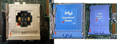

Reply 7 of 8, by Horun
Blue 486 Overdrive sockets are 1 pinned same as socket 3.
    84.5 KiB
    115 views

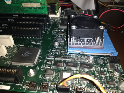

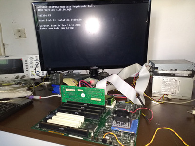

Reply 8 of 8, by dataino.it
THX
fixed ( removed bios password ) by removing the dallas DS 12887 and install new one !
installed CPU in the correct way and run !
