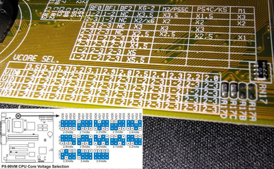

Sorry for digging up old thread, but I have K6+ P5-99VM related observation
I have rev 1.03.
Updated patched bios for "+" support. (Thanks @JSO for AFLASH V2.21 hint.) Followed PCB silkscreen VCORE jumper configuration - no post.
Took out multimeter and measured directly VCORE CPU pin - 0 v reading. No power whatsoever.
With 2.2V configuration MB posted with no issues.
Strangely enough manual gives one more option for 2.1V and this one is working as well. So I settled with that.
I have no experience with K6 CPUS. Back in the days I went Cel300A route, but if I'm reading internet correctly then +0.1V for K6+ is under AMD max voltage spec.

Reply 9 of 10, by Chkcpu
Hi Vutt,
Although the K6-2+/III+ CPU core is designed to run on 2.0V, it also runs well on 2.1V.
The absolute maximum Vcore rating is 2.2V, but this is already stressing the CPU and will probably shorten its life span.
On SS7 motherboards with 4 Vcore jumpers, the lowest possible Vcore setting of 2.0V is usually selected by taking all 4 jumpers off. I have found that several boards didn't work with this setting and that the next higher setting of 2.1V had to be used to properly run the K6-2+/III+.
However, this depends on the type of Vcore controller used on the board and most Super Socket 7 boards do correctly support 2.0V Vcore.
So 2.1V is fine. I’m running my K6-III+/550 at 600MHz on 2.1V Vcore for more than 15 years now, and its still rock solid. 😉

Reply 10 of 10, by vutt
@Chkcpu
Yeah after reading more about K6+ indeed many have reported K6+ running just fine with slight overvoltage. Thanks for confirming it.
Btw. with 2.1V my 500Mhz K6-2+ version seems to be working sable with 5.5 multiplier. I intend top use it mainly for DOS/Win31 so overclocking is not top priority.
