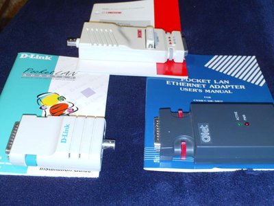

I searched all my parts, but only found these Pocket LAN adapters..
* D-Link Pocket LAN DE-620 series
* CNet Pocket LAN Ethernet adapter CN50ET/50E/50EU series
* ShineNet Pocket LAN LCS-8834P-TB, LCS-8834PM series
I'm sorry that I wasn't able to find that Xircom..
Maybe we're lucky, though, and some of them is compatible to it ?
I mean, it wasn't unusual to sell one product under different names.
Anyway, I tried hard to keep my promise.
I'm sorry that I wasn't able to fulfill it as I wanted to.
