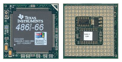

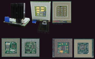

Recently, I created an interposer module to translate the 168 pins (486 socket) of a Texas Instruments TI486SXL2-G66 to that of a 132 pin socket (386). From what I could discern after reading the TI486SXL Reference Guide, found here: https://archive.org/details/bitsavers_tiTI486 … eGuide_19799789 , the TI486SXL2 PGA168 should be the same as the QFP144 and PGA132 variants with minor exceptions. QFP144 and PGA168 have the FLUSH circuits built-in (although you do not have to use them if you don't wire up MEMW#), they have a FLT#, which can be left floating as it contains a built-in pull-up resistor, they run at 3.6 V, and have a few more GND (Vss) and voltage (Vcc) pins.
So what would prevent someone from just wiring up the PGA168 pins to the location of the PGA132 pins on an interposer socket and using a voltage regulator module to run the CPU at 3.6 V? The TI486SXL2-66 chips in PGA168 format are readily obtainable new for $15. An upgrade company made such an interposer for the QFP144 TI486SXL2-66 and another user here has tested it. The TI486SXL2-66 (PGA-132)... & repair! and Re: The Systempro; Benchmarking (TI486SXL2-66)
Aside from the IBM BL3 and a Transcomputer module, the TI486SXL2-66 would have been the fastest upgrade for your aging 386. The SXL2 is still architecturally a 386, but with cache and 486 instructions added. Considering how much the SXL2-66 upgrade QFP144 sold for recently, I figured there might be interest in creating an interposer board for the more common TI486SXL2-66 PGA168. I planned to start with a proof of concept prototype, then possibly create a proper PCB if there was sufficient interest.

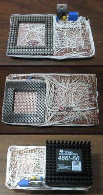

Here is the prototype:
1.3 MiB
9347 views
I built the prototype using a snap-able solder boards, a MIC29302WT (LDO = 0.37V @ 3A), 10 uF cermaic input cap, 10 uF tantalum output cap, a resistor, a trimmer, and solid core 28 & 30 AWG wire. I tested several linear and switching voltage regulators before deciding on the MIC29302WT. I finished the prototype after about 10 days of casual soldering.

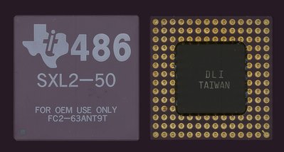

Unfortunately, I could not get the prototype to work in any of my 386 motherboards. In each motherboard, the TI486SXL2-50 PGA132 CPU worked fine though.

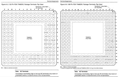

I basically soldered the PGA168 socket directly to the pins of the PGA132 socket using the template found in the TI486SXL reference manual.
396.01 KiB
10052 views
The exception is that the Vcc pins on the PGA168 side get wired to the output of the voltage regulator instead of the 5 V line from the PGA132 side (the motherboard). I have the trimmer set such that the voltage to the CPU is 3.60 V. I confirmed this after the prototype was powered on in the motherboard. I have checked each solder connection three times now and also confirmed that none of the wires sorted to any of the other pins, e.g. while soldering some pin, the cladding on an adjacent wire melts and unintentionally caused bare wire to touch. I checked every wire using the beep function on the multimeter to ensure there was no accidental connection somewhere. Perhaps there is still some cross-talk?

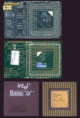

I noticed on the QFP144 upgrade module that there are some extra components, such as additional decoupling capacitors, a NOR gate, and a PAL. Here is what it looks like,
310.95 KiB
9347 views

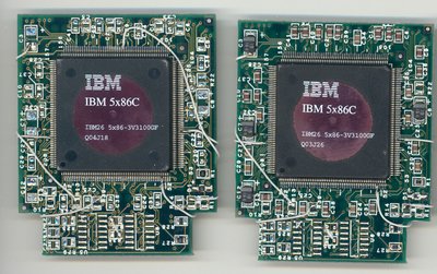

I have come across many 486 upgrade interposer boards which also contain programmeable logic device, such as PALs or GALs, and gate circuits. On many motherboards, these were not required. I believe that they were usually added to increase compatibility with various systems, mostly archaic or non-standard motherboards. Considering that all my 386 motherboards work fine with my 5V PGA132 SXL2 chips, I do not think any special logic would be required on my prototype. Could there be some other difference between the PGA168 and PGA132 SXL2 chips that has eluded me? My gut feeling is that there is something very fundamental I have overlooked. Any ideas? Help!
Concerning the increased number of decoupling capacitors found on the QFP144 upgrade unit; while they may help, I do not believe their absence is causing the no signs of life symptoms. For example, in my experience with these IBM 5x86c-100 chips, the dozen+ decoupling capacitors did not change the stability of the system, not even at 133 MHz. I have two such interposers; on one I removed all the caps, and on the other, I left them on . Both demonstrated equivalent stability in the system I tested them on. While I could add one or two extra decoupling capacitors to the TI486SXL2 prototype, I don't really think it is going to help with the absence of life. The prototype, when installed in the motherboards, does not show any signs of life - that is, the screen never displays anything.
274.03 KiB
10052 views
With any luck, I might be able to borrow one of these QFP144 SXL2-66 upgrade kits from a CPU collector and try to determine what they did differently. Obviously the manufactured QFP144 unit is interrupting some pins and taking them to the NOR gate and to the PAL. Unfortunately, I won't know what the PAL is doing, but at least I'd know which pins are interrupted. Perhaps the PGA168 and QFP144 units need some trigger to wake-up, and that is what the PAL is performing? Perhaps the mystery is with FLT#
I have three of these TI486SXL2-66 CPUs and I tried them all, but the result was the same. I also tried setting FLT# to ground at startup and also to set FLT# to GND after power-up, but the result was the same. FLT# is for floating the bus signal. FLT# and MEMW# are the only two pins the QFP144 and PGA168 chips which are not on the PGA132. I do not really understand what FLT# does, but I will copy/paste here what the reference manual says about it.

I also tried using the Transcomputer 486HPi upgrade module with the TI486SXL2-66 installed. I set the Transcomputer module up for 486SX pinout, but I did not see any signs of life when powering on the system. I can even use the Transcomputer with an AM5x86-133 chip and still have the 386 motherboard work fine.
936.07 KiB
10050 views
An Intel 486SX CPU also worked fine on my 386 motherboard. To me, this confirms that there are differences which must to be considered when installing a 486SXL2-66 onto a 486 motherboard. However, a 386 motherboard is already wired up for a TI486SXL, so the prototype should work! I tried the TI486SXL2-66 in the Transcomputer at 5 V and at 3.6 V (by using a variable voltage VRM on top of the Transcomputer). Actually, I tried three different VRM modules on the Transcomputer, but still did not see any signs of life.
1.18 MiB
10050 views
This is everything I have tried to date and am out of ideas. Any thoughts on how to get this prototype working would be much appreciated.

Have you tried using a logic analyzer to see if there are any signs of life at all? I don't think at this point you're going to get very far without one.

There is QUITE a bit of glue logic going on. Even on my 386 > 286 upgrades. The chip you are wanting to use might have the internal glue logic physically disabled. Thats my first line of thought.

Jesus, that Kingston thing is loaded with glue logic chips, far more than what the Transcomputer 486HPi has on it. Does it work with a DX4, Cyrix 5x86, or DX5? And is it specific to a particular system? Do you have any of the Transcomputer modules?

I have been thinking.
a lot of these adapters have the math copro onboard. 486 is in-chip, but maybe the glue logic catches certain copro op codes and make sure its seamless to the mobo.
also, maybe there is a wiring mistake on your adapter. one crossed address line... i dont doubt your diligence, I'm just looking for the most likely issues.

an isa diag card wont help with an interposer board. they rely on a working cpu, and they only do certain specific tests which wont really help you.
you need a real logic analyser (not a usb toy one either). I have a HP 1670G ist a beast. with all the exposed pins on the interpose board it should be a cakewalk to connect and probe pins.

The only way the issue could be co-pro related is if the 486SXL2 was a a 486DX. Remember, the 486SXL2 PGA168 is the same as the 486SXL2 PGA132 chip. So the motherboard is already wired up to work with a seperate co-pro. It is only when you insert the 486SXL2 PGA168 into a proper 486 mothreboard that changes must be made concerning how the co-processor is wired.
The most likely issue is wiring. But I checked in 3 times - once while soldering, once when everything was finished, then again after it didn't work following my first test run. After I had finished, I did find two wires (out of 168) that I messed up the pin location. When you've been soldering too long and are always turning the chip over, you can sometimes confuse the top and bottom.
I really don't know what to check now. I did more reading in the manual concerning FLT#, and it was recommend that this pin be used for testing only. So it sounds like it is not where the issue lies.

well you dont need to hook up EVERY pin, and the waveform timings are in the intel manuals etc.
start small.
test clock pin, is the CLK signal coming through the interposer?
is the cpu sending out its mem fetch signal on the bus? test address line 0, it should pretty well oscillate as the lowest address for fetching data..
work up, then you can monitor the entire data + address bus or something.
