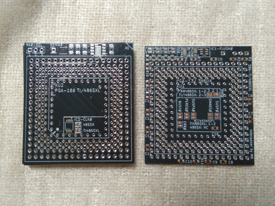

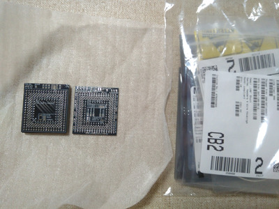

Reply 1126 of 1184, by MikeSG
The only connections I can see on the folded/flexible circuit to the CPU are Flush, HLDA, VCC, GND... HLDA can be used with MEMW to activate Flush, but it seems to be doing it without MEMW. After a certain amount of clocks has passed while HLDA is active, Flush is activated? Not exactly sure.
On the interposer I designed, IC1-FLUSH takes HLDA + MEMW (or M/IO and SO) to activate Flush. ... Or,"MEMW#" the large single pin header on top connects to the TI486SXL's MEMW pin, which activates flush.... Or, you can not use either of those and use the Cyrix utility to activate BARB, which activates Flush on each HLDA.
The flexible circuit with ripple counter does seem to be the better way to suit all types of boards, though. If I need to do a redesign it may be better to do it that way.
The parts for my design came in the mail in the last few days, just need to wait ~a month for the sockets.

Reply 1129 of 1184, by MikeSG
There's smaller versions of the LDO regulator I'm using that are still rated for the same spec. The solder/thermal pad is connected to the entire top layer and stitched with 18 nearby vias to the central large GND plane, and bottom layer. This is the datasheet (in SO-8EP): https://www.diodes.com/assets/Datasheets/AP7363.pdf
About the caps, the 100nf/0.1uf caps share one or two VCC pins each, the top six VCC pins have no 0.1uf caps but are close to one central 0.1uf and the three 3.3uf caps. I made a mistake though, the vias next to the 0.1uf pads (side & bottom caps) don't do anything because the VCC & GND pins on the socket connect straight through to VCC & GND anyway. VCC is supposed to come through the twin vias then past the cap to the VCC pin. Your design is probably better for noise but I just wanted it to be neat.
Soldering all the PGA-132 pins in rows in a specific order, trying to work out how to solder both top & bottom sockets by hand I don't want to do... Yes both the PGA-132pin and the PGA-168pin press fit are ~$50 AUD/CAD each, or ~$33 USD each.
I don't know how mass producible it is... the sockets total $100... the rest of the components are cheap though. Maybe another $50 for PCB + other parts. For one interposer. If it works I'll build left-overs or "build it yourself" kits and put them on eBay. How many people are actually looking for a solution?
The Improve-It circuit is clear, thanks.
