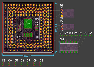

The first study for PGA-168 without placing the parts:

Aerion, nice work! Some comments thus far:
If you were to rotate the VRM by 90 degrees and place it towards the bottom, would you be able to fit in one of these mini DIP switches under the CPU? See the mini-DIP SW in the Trinity Works module here: download/file.php?id=50039&mode=view
Scratch that - an even better suggestion would be to place the DIP SW on the very bottom of the PCB. This way the user wouldn't have to pull out the CPU to adjust the CPU voltage.
After further thought, since we are going to have an exposed header, it might be good to have the FLT# pin brought out next to the GND pin header. FLT#, when grounded, would allow the SXL2-66 chip to be disabled, thus preventing the need to remove it from the motherboard if the user wanted to use an on-motherboard soldered-on CPU.
I'm curious why you think we need to have 5V and GND next to MEMW#?
I would arrange a 4-pin header like this: Vcc, MEMW#, GND, FLT#. Note that I've placed Vcc on the header, not 5.0V. This Vcc (3.6V) header will be helpful for the user to measure the CPU voltage with a multimeter.
I looked through the wiring of the VRM; it looks correct. On the testbed, I had R7 = 121-ohm, and SW1's resistor at 230-ohm, which yielded Vcc = 3.62 V at 0-ohm load, or 3.65 V at 360 mA - 730 mA loads.
My notes indicate that I went with a 10 uF ceramic cap in the input and a 10 uF tantalum cap on the output. I'm not sure if the load cap needs to be a tantalum, but the MIC29302 datasheet mentions, "Tantalum capacitors are recommended for systems where fast load transient response is important."
Note that TAB is GND according to the Microchip datasheet.
How many layers is the layout?
Are cross-talk, trace capacitance/inductance, reflections, impedence matching, etc. optimised for 66-100 MHz operation?

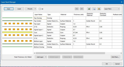

I have planned 4 layers (GND plane - Signal layer 1 - VCC plane - Signal layer 2). The VR (TAB) is soldered directly to the GND plane. This also guarantees cooling.

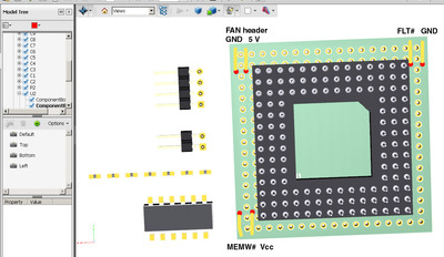

Reply 192 of 1208, by feipoa
Thanks for sending the 3D drawing. I didn't realise Acrobat could display 3D images and allow you to rotate them, view layers, sketches, fill, etc as an option. I'm really outdated.
Yeah, a rotary selector switch would be preferred. Were you looking at model SS-10-16SP-AE from that link you sent? It is a single-pole, 6-throw rotary selector. The issue may be its height of 7 mm. Obviously, we'd want to minimise the gap between the socket and the PCB as much as possible. I'm pretty sure I can get that gap between the sockets and the PCB down to zero, even without solder paste, though I'd like to try some solder paste tests as well. Thus we wouldn't want to source a switch who's height is taller than 4 mm if placing the switch under the PGA-132 pins, which is the preferred location.
For that reason, I have sourced some lower profile rotary switches. Unfortunately, when going shorter, the options for throws is limited. The most common is 4-position and 10-position, with 10 being the most common. 10 positions seems overkill for a VRM on this board, and requires more resistors, but if there's space...?

I was also doing some thinking about the headers. Instead of having to increase the PCB real-estate, would it be possible to place the headers on the bottom of the PCB like shown in the mocked up photo below? Note that voltages are deliberately placed inside and GND outside, where possible. I suppose the drawback to putting them on the underside is if there are some components below that hit the headers.

I was wondering if it is possible to trim the the PCB footprint down to the area of the white line shown on your photo, that is instead of the red line? I went through several of my 386 boards and was noticing that most manufactuers tend to leave about 4 or 5 mm around the PGA-132 socket before any components turn up. Trimming the PCB to the white line could save about 0.7 mm in either direction.
In most cases, the headers on the bottom wouldn't be used and could even be cut off, desoldered, or never installed if in the way. Thus placing them on the bottom seems like the preferred option since this reduces PCB area. Another idea is to place the headers either under the CPU or inside the PGA-132 foot print, but the user would have to run the wire between the CPU pins which seems tacky.
