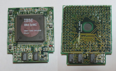

Recently, I was fooling around with a QFP IBM 5xc86c on an interposer meant for an IBM Thinkpad. I thought the quantity of decoupling capacitors was rather impressive, since some 486 interposers (the type without VRM's) don't have many, if any, caps. I pulled the caps on another of these interposes I have, which wasn't working, and measured the caps.
They are:
10 pieces of 3.3 nF
10 pieces of 10 nF
7 pieces of 100 nF
4 pieces of 10 uF
31 total
I figured that surely the Vcc noise must be pretty decent, so I selected a point on the PCB's overhang to measure Vcc3, but Vpp with all 31 caps was around 375 mV when run at 2x66 MHz and 3.73 V. The noise was measured in a Lucky Star LS486E revD board, which has an onboard TIP127 voltage regulator. The same interposer, but without the 31 caps, the noise was really bad at 850 mV.
I thought I would share this, considering that the noise we are dealing with on the SXL2 interposer is 90 mV. Makes me t hink that the noise on VCC3 isn't all that important.

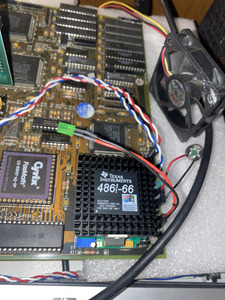

Reply 969 of 1213, by Sphere478
1.72 MiB
1251 views

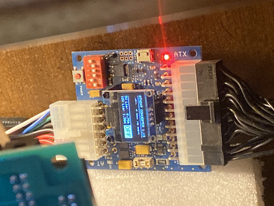

The physical build on my end has been challenging to say the least. My soldering skills areen’t exactly world renowned and there are many fine connections to be made.
I did however after playing with it for weeks/months for a hour here and there far between finally get one assembled that I think was safe to test.
The keen among you will note the lack of a ceramic output cap. I thought I had one in my selection of caps, apparently I was mistaken. I decided to try the unit without it none the less. This may be the reason it isn’t turning on.
The system works before and after the attempt with the built in amd 386 dx 40 but not with the unit installed.
I am getting - - on the post diag card.
Is it possible that the onboard chip isn’t being disabled?
Do we need to add a disable pin for the unit?
I can try again once I have sourced the proper output cap for the unit.
I used a 260? Ohm resistor for the voltage divider and that allowed me to get 3.33v right on the nose with trimming. Unsure if that will allow 5v though. Feiopa, what resistor are you using?
As added precaution I used this handy device for the test. No over current event was triggered.
Thoughts?

Reply 970 of 1213, by feipoa
I see Cout connected. I don't see Cin. If I recall correctly from one of the datasheets, Cin was strongly encouraged.
For MIC regulator, I'm using 121-ohm
For LP regulator, I'm using 1K.
The most likely cause of your non-responsive motherboard with the SXL installed is because you didn't disable the onboard Am386.
Concerning disabling the onboard Am386, you need to either:
a) locate the jumper (or hard-soldered jumper) on the motherboard with disables the onboard Am386, if such a jumper exists, or
b) connect FLT# on the Am386 to GND, e.g. as shown. You needn't lift the lead; you can just solder FLT# to GND assuming FLT# isn't connected elsewhere. If FLT# is connected elsewhere, lift up the pin.
262.88 KiB
1238 views
I recall we went over this previously. Did I remember incorrectly?

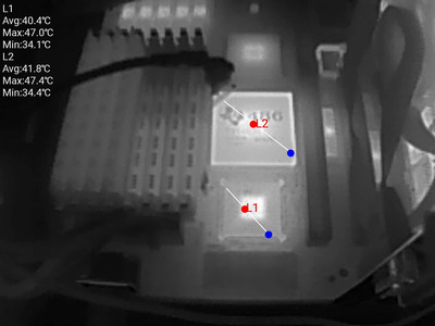

Reply 974 of 1213, by Thermalwrong
pshipkov wrote on 2023-05-29, 00:40:
Wouldn't option B cause the CPU to still draw electric power ?
Asking because recently was affected by less than ideal 5V rail issues.
Do you know ?
I can confirm that it does - I just did this modification for a regular 486DLC CPU and checking it, both CPUs are drawing power and generating heat even though the onboard CPU is definitely inactive.

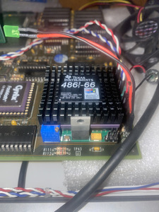

Reply 978 of 1213, by Sphere478
Okay I finally got the 10uf capacitors in, I went ahead and installed them on all the 5v pads. Why not…. Verified 3.33v at interposer and installed sxl2
Anyway. Still no post codes.
The board boots off the onboard dx-40 with the interposer installed but not with interposer and sxl2 installed.
I don’t have any 386 cpus to try in this motherboard. I was supposed to get a bunch from someone but they never sent them. 🙁
That kinda messes up my plans, I’m a little short on money rn so probably won’t order one.
I was going to take the multi meter and study the grounds on a pga 386 and do some tracing on the motherboard to try and figure out how a normal 386 disables the onboard 386 but I don’t have the cpu.
Trying to find the datasheet for that amd dx-40 … anyone spotting that online somewhere?
Next time I get a second I am going to try and trace the flt pin from the cpu as indicated and see where the traces take it.
I did try jumping the indicated pins in previous post it led to over current event on my at2atx adapter. Best guess is that pin is being pulled high by the motherboard. And that created a 5v short. I didn’t pull the pin as I recall it being said that it was okay to jump it without pulling it up this seems to not be the case. Board is fine though. 😀 thanks to that device. I still don’t see a jumper for doing this?
If it really comes down to it I can pull the cpu, but I kinda really want to leave it there unmolested.

Reply 979 of 1213, by feipoa
If you have already connect FLT# to GND and it caused an over current condition, then try lifting up the pin as I've shown in my photo and bend it to the side (GND). Thinking about this further, I think you can only wire FLT# to GND if the motherboard isn't connecting it to Vcc. FLT# has an internal pull-up resistor and, according to the datasheet, if FLT# is not used, it should be left disconnected. Thus I am surprised that your motherboard was sending FLT# to Vcc. However, if you look at the photo I provided, it looks like FLT# on my motherboard was also being sent to Vcc, in contravention to the datasheet. It has been many years since I did this mod, but it looks like I did the pin left up because I noticed FLT# was going to Vcc. Sorry, I didn't remember this.
You really need to get any PGA132 CPU to continue testing, preferably a Cx486DLC or Tx486DLC. These should be like $15 max. EDIT: I just looked on eBay, and am in disbelief, wow! There's tonnes of these chips, but how did the price of jump to $50 or more? Cheapest I could find was $40 https://www.ebay.com/itm/134349014775 I suggest hit up CPUShack to see if he has any extra he doesn't need. He probably does because I cannot see these selling on CPU-World since collectors already have them.
The datasheet for the A80386DX can be found on digikey. They are still selling these!
https://www.digikey.com/en/products/detail/ro … DXL-25/12095484
By the way, you should be running your SXL2 at 3.6 V or higher, not 3.3 V.
