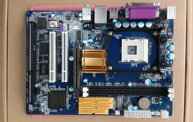

a quick Google search shows a lot
https://www.google.com/search?q=agp+isa+matx& … iw=1195&bih=588
A few.
http://www.tiger-technik.de/images/product_im … ages/1185_0.jpg
https://ae01.alicdn.com/kf/HTB1Mk52KVXXXXbXXX … PCI-1-AGP-4.jpg
http://baber.com/baber/gifs/411gifs/spacewalker_hot687.gif
You best bet is ether slot1 or SK370, maybe ssk7.
