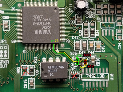

So, that was it. Removing RP1 allowed the system to POST, and the card to work as expected/previously established.
Modifying my config.sys and autoexec.bat to include the appropriate drivers, produced a working CD-ROM drive in DOS!!! 😊 You have no idea how happy I am.
So, the successful steps are exactly as I previously thought:
1. Add 40-pin header
2. Remove 0-ohm array RP1
3. Remove SEL0, SEL1 resistors and re-orient to provide alternate SEL value (pin 73 to 5V via 10k, pin 72 to GND via 0-ohm).
One thing that I didn't quite understand at first is that the Yamaha drivers set include SACDROM.SYS which basically does the PnP thing and initializes the I/O and IRQ to be used by a normal ATAPI driver later, like OAKCDROM.SYS. When I first tried this, I thought SACDROM.SYS was also the ATAPI driver (and therefore replaced OAKCDROM.SYS), but it doesn't, it just does the I/O. And stays in memory, taking up 6k... but whatever, I guess. After figuring this out, I was a little concerned that OAKCDROM.SYS might not recognize the tertiary IDE interface I/O (1E8) and IRQ (11), but it works just fine.

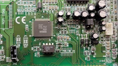

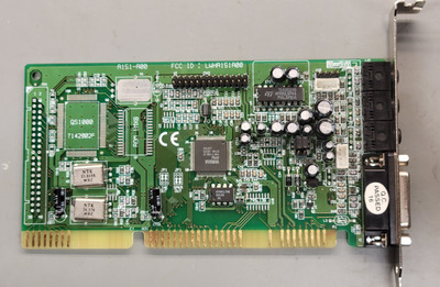

I know this is a pretty old thread, but most of the image links seem to be dead. Does this look like what you did to get your IDE working?
YMF-719 Card (A151-A00)
file.php?mode=view&id=153728
Before
file.php?mode=view&id=153729
Modifications:
- Add a 40 pin header
- Remove RA2 (Already missing)
- Remove 0-ohm array RP1
- Move the 0 ohm and 10K ohm resistors as shown in the pic below
file.php?mode=view&id=153731
Reply 22 of 23, by Tiido
RA2 needs to be left alone, it is there for cards with single 33.8688MHz crystal and it routes it to the 24.576MHz crystal pins so the card can function at cost of 32, 48KHz and few other sample rates being much higher pitched.
