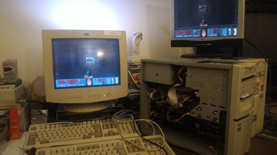

Reply 8 of 50, by Illy76_it
Hi guys,
IT WORKS! Thank you to all, thank you very much, thank you!
For this configuration, I use a Realtek card and one unknown card (which have 2 big squared chip: TI and another one) : the RTL8019 work with realtek drivers, the other one
with generic NE2000 ipx drivers. I want to try various network card because the Realtek work like a charm in WFW 3.11 with TCP/IP, therefore I want to keep for this use. Instead,
for DOS multiplayer, the network card It's just enough to work with NE2000 generic driver, I don't care about another use, and on ebay the Realtek are very expensive.
(sorry for any grammar error 🙁 )
Here a pic of my work in progress 😀
Thank you again guys!

Reply 9 of 50, by Illy76_it
Deksor wrote:
depends which cable you use if your cards can't swap the rx and tx lines by themself. Otherwise, to be safe, just use an ethernet switch ^^
Ethernet switch is the answer 😀
For a real vintage LAN, I have to connect the 2's pc with a coaxial cable, but... 😁

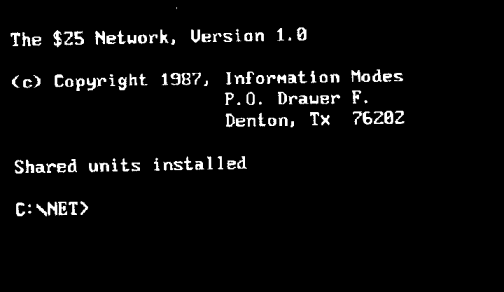

Reply 18 of 50, by Jo22
Deksor wrote:
Nowadays it could be cool if somebody made this to connect to modern microsoft shares so we wouldn't need to modify windows' way of managing shares [..]
How about using a Raspberry Pi then ? 😀
A while ago we had a few discussions about using a Pi to access network shares.
It was mainly about the set of difficulties involved to create a share
that can be accessed by both old and new Windows releases.
Maybe this can also be applied to IPX ?
Back in the 90s people used to run Win95 machines to integrate good ol'
RS232-based 25$NET (aka Kirschbaum-Link ?) network shares into TCP/IP or IPX networks.
What they essentially did was to load the old DOS network software before Windows
started and then made these "drives" available to the modern networks.
I know for sure that at least older Linux kernals had some sort of IPX support.
No idea, though, if this ability is still a part of Raspbian.
