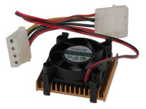

Reply 4 of 6, by lazibayer
I happen to have two of each, but they are all for ceramic pentiums. I couldn't find the clip base for the two screw heatsinks. I took them off because they won't fit on the later cpus with gold humps.
    65.18 KiB
    499 views
