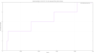

Reply 18 of 31, by TheGreatCodeholio
Okay, I just tested traditional SB time constant and playback commands on a SB16 card.
I just finished a TS_PD.EXE test program that plays a sample on SB hardware and records the DMA position vs time to a file.
The SB16 has a FIFO but the backwards compatible SB 1.x playback commands seem to act as if the FIFO is only 1 byte large.
When I have more time I'll see how some other cards respond to this, and whether this applies to the high-speed DMA and SB16 playback commands.
I fully expect the ESS688 chip to show it's documented 64-byte FIFO in these tests, I'll see if that holds up.
EDIT: Well, actually the graph might mean it has a 2-byte FIFO in this mode. It appears to rapidly DMA 2 bytes and then DMA single bytes at the sample rate afterwards.
Creative Sound Blaster 16 AWE 64 PnP - SB 1.x DMA single cycle DSP test, 4000Hz, 4000 bytes.start.png
19.11 KiB
2265 views
