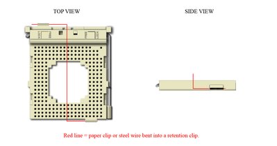

nope. You bent the paper clip in such a way that it's extremities go under the two tabs on the socket , and the middle part sits on the heatsink itself - but this only works for socket 3 boards. If you're using a socket 1 board, the only way of attaching a heatsink is thermal adhesive...
Here's a pic posted on another thread by tetrium: http://photobucket.com/gallery/user/inteltetr … 3NjkyNw==/?ref= bend the paper clip like that.
Here's a quick diagram I put together:
140.02 KiB
1092 views
The red line represents the heatsink clip. Most socket 3 boards have some 2 tabs, diagonally opposite from each-other that can be used to hold a heatsink in place. Hope the diagram makes sense.

Mind you, I believe this only works for SOME socket 3 boards that have this specific thing on it (Mine does NOT). The best heatsinks are the ones with the plastic clips.

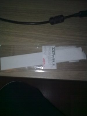

Glue tape to install heatsink :
92.04 KiB
1049 views

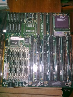

Board and Cpu : (someone knows the manufacturer and type of this board ?)

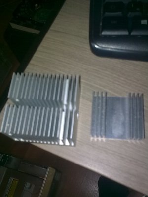

Heatsinks :
121.14 KiB
1049 views

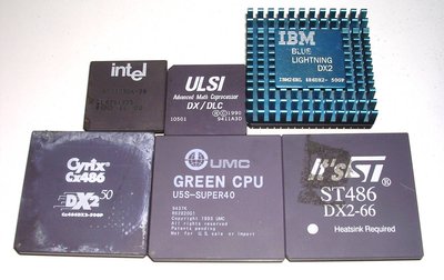

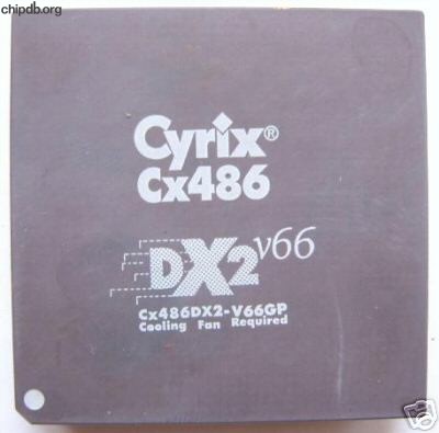

Reply 32 of 73, by Radical Vision

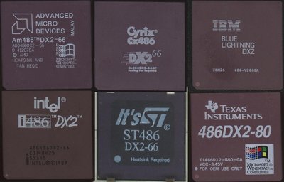

Lol they say even on the CPUs that heatsink and fan is required so......
If you want fanless and heatsinkless build grab some 386 as they don`t need cooling at all....
K7 2.6/ NF7-S/ HD3850
Cmq P2 450/ GA-BX2000/ V2 SLI
IBM PC365
Cmq DeskPRO 486/33
IBM PS/2 Model 56
SPS IntelleXT 8088
Reply 33 of 73, by Scali
They do? I've only ever seen that on AMD ones, and that is because AMD binned them lower than Intel to undercut prices (cheaper to add a heatsink+fan).
Reply 34 of 73, by Radical Vision
Well is interesting, some of them have the heatsink/fan req. on them, others don`t, intel, texas instruments and IBM seems not to have on their processors this. Also some AMD processors don`t have that as well...
