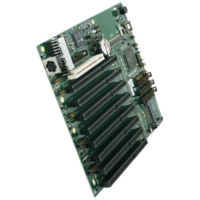

I guess the simplest solution would be to make something like this:
64.86 KiB
2680 views
But in ATX form factor since AT cases are scarce in some parts of the world, and more PCI slots. The above board uses a ZFx86 SoC based on the Cyrix 586 core (I think - not 100% sure). The only issues with the above board is that it doesn't come with any L2 cache, and there's no way to add any - and it only has one PCI slot.
The cool part about the ZFx86 SOC is it's built on a modern manufacturing process, so it should be able to go faster then 133MHz. It supports 2x(4x) and 3x multipliers internally, and runs over the 33MHz FSB. I don't see why it wouldn't run at 2x66MHz, or 3x 66MHz for that matter. It would make for a really fun, fast 486 class machine to play pentium games on - think cyrix media GX with L2 cache and Fast FPU = ON.

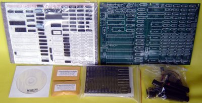

Nobody said it would be easy... but it is possible, and it could make money if crowdfunded trough something like kickstarter while being sold in parallel on it's own website.
To keep cost down, unassembled kits could be sold. Just provide the PCB (with BGA parts pre-soldered) + the rest of the parts as a kit, just like this: http://www.mtmscientific.com/pc-retro.html
517.93 KiB
2590 views
I know I'd personally want the unassembled kit, and it would be great fun to put it together myself. Like I mentioned before, BGA parts would need to come pre-soldered, since they require specialized equipment to solder correctly. PGA parts can be soldered by the buyer by means of a SMD rework station witch is not an expensive tool.
I'm going to order one of those boards with 512k of ram. Total cost is 200$, and you get a DIY IBM XT clone - awesome.
Of course there should be an option for pre-assembled boards, for those who lack the skill and equipment, or are simply not interested in that aspect.
