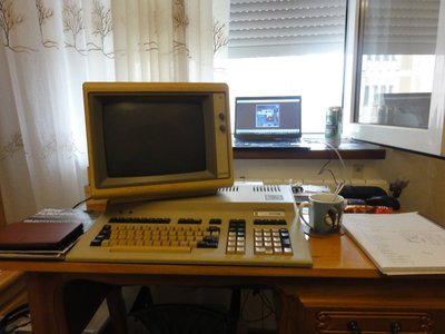

Tulip System 1
I have this Tulip System 1 computer which was a Dutch donation to the Romanian Institute for Electronics Research (ICE) back in the '80s during Communism.
My father was a researcher at the Institute up until the late 90's when chronic lack of funds and corruption closed it for good.
This 8080-based clone was my first ever contact with the world of computing.
I loved spending time in my dad's office, it felt like being in Dexter's Laboratory but this computer was the highlight of that place!
Eventually, rough times came for the Institute and my father had to quit his job. While clearing office, I did everything a 6 year old could do in his power to convince my father to save the Tulip.
I hauled the entire system, piece by piece myself to make sure that the Tulip did not go to scrap.
Unfortunately, by the time I salvaged the computer from the Institute, it was no longer in a functional state: The PSU was cannibalized for parts and other projects and the dual floppy unit was missing its data cable.
After I salvaged that computer, I made a solemn vow that one day I will learn hard and gain enough knowledge to bring the Tulip back to life.

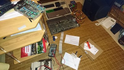

On the operating table...err, floor

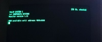

In 2012, before leaving to study Games Design in UK, I took a multimeter, a pen and paper and started mapping the motherboard's power connector pins to the VCC of known ICs in order to create a PSU for the system.
With help from my father and an oscilloscope, we managed to figure out the video output connector in order to create a video cable to hook the Tulip to the green monochrome monitor we had.
And the beast came back to life!
38.04 KiB
1659 views
Its alive!
After finishing Uni in 2016, I returned home and got back to my Tulip to restore it.
Unfortunately, its ROM contained no more than a system loader and monitor and I still had no functional floppy drive.
A boot entry in the system labeled "Boot MS-DOS from EEPROM" led me on a wild goose chase looking for an MS-DOS boot header through its EPROM chips with no results.

Took a quick look at this. The BIOS image are the 15 and 16 Files (Lo+HI). Combined you get the attached. Execution starts with
F000:FFF0 JMP FE00:03E2
But menu seems to be included here
[i]B - Breakpoint
C - Copy
D - Dump
E - Eprom boot
H - Help
I - Input
J - Jump
M - Memory test
N - Network boot
O - Output
R - Read seg:off trk side sctr drive 5/8 r
S - Set
ESC - Load operating system
_
TULIP SYSTEM I
(c) COMPUDATA SYSTEMS_
Monitor version 1.31
RAM available until address: _
Bad RAM_
Try again_
No valid command_
Value error_
**** WARNING : RAM ERROR DETECTED ! ****
_
Disk unit not ready_
Record not found_
Lost data_
CRC error_
Loading operating system _
No loader present on disk_from 5.25"_from 8"_from hard disk_______CDATA2.0
[/i]

To complicate things further, the floppy drives were Mitsubishi M4853 drives - Shugart-34 compatible.
The Tulip motherboard however, had a 50 pin floppy drive connector.
I made an educated guess then and assumed that the floppy connector on the Tulip motherboard was Shugart-50 compatible in order to maintain backwards compatibility with 8" floppy drives.
With this in mind, I then proceeded to create a Shugart-34 to Shugart-50 adapter cable which was an exercise in patience hahaha.
Your educated guess was off 😉 I have a Tulip system 1 with working floppy drives, and the cable to the computer is a 34 conductor one; on the 50 pin connector on the main board, pins 1-16 are not used, and then it's straightforward, so pin 1 from the cable goes to pin 17 on the connector.
