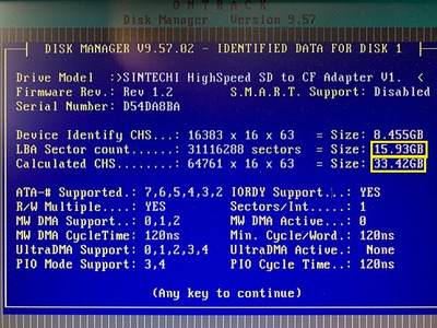

I have a shuttle hot 419 motherboard with a sintechi sd2ide (SD35VCO) with a 16GB Samsung SD.
The current Bios (dated 12/1993 ) only supports up to 528MB. Ordered an eeprom burner so I can upgrade to a 1996 bios, but that's where I am today.
So I got the 9.57 Ontrack Disk overlay.
The LPA sector count always looks good at 15.93GB, but depending on which IDE drive geometry I select in the BIOS setup, I get total drive space of 23.3GB or 33.4GB for the calculated CHS space.
95.93 KiB
313 views
I've plugged the SD into a modern computer and confirmed that it's only got 16GB. When Ontrack partitions ( or if I use Fdisk after loading the overlay) I see the calculated CHS space as the drive size, which is too big.
Pretty sure I'll have problems if I make volume larger than the actual device size, so I've just been using an 8GB partition, which is plenty large for Win98se. Still a little worried that I could get drive corruption, but you know, this is retro computing on 27 year old parts. Data integrity is never a given. Still, I'd rather keep the list of possible causes for drive corruption to a minimum.
Any advice on how to get Ontrack to see the drive correctly?
Otherwise the device works well with windows 98se, except sometimes in locks up on shut down. I get the shutting down screen, but never get the "It's safe to turn off your computer" screen.
Reply 2 of 6, by jaZz_KCS
Sadly, no. As I have very little experience with OnTrack as I almost always use EZ-Drive. OnTrack led to complications sometimes when trying to load the SD card in another machine. And I have never had any use for the "Boot from CD-option", as the systems in question are Win98SE max and most of these discs are not even bootable and you can simply install by copying the setup files over to a different partition.
Out of curiosity, could you make a bootable disk out of the image provided below and boot from it, selecting "Full-Automatic Setup" (don't worry, it will not start erasing things just yet, but will tell you whether your BIOS supports the drive(it doesn't), but also afterwards will ask you how to set up the desired partitions. And it should tell you the correct drive size.
This might not work with Ontrack present. You might have to wipe the card first. I never had any problems with EZDrive detecting wrong sizes... If is also does that like OnTrack, then it's safe to say the card is iffy and not suitable for such a scenario.
    ez-drive909w.zip
    357.28 KiB
    15 downloads

Reply 4 of 6, by douglar
Much happier with the EZ-drive firmware.
  • the drive is identified correctly regardless of geometry configured in BIOS
  • Partitions are visible from windows 10
  • I don't need special drivers for protected mode IO in Windows 98
