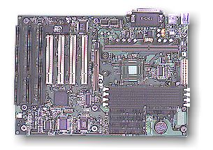

Got this Promise FT440BX Slot 1 mainboard, but I'm not able to find any infos on it. Is it any good? Has RAID on-board, it seems. Would like to get my hands on the manual.
//edit:
Found the press release: https://www.thefreelibrary.com/Promise+ ... a050277591
Mainly interested if it works with a Pentium III 450 MHz.

If I had to guess, anything pre-Coppermine will likely work (so probably yes to the 450 MHz P3) .
Coppermine support will depend on VRM capability and BIOS support .

It's a very early BX board (note the date sticker on the BIOS), so full Katmai support is unlikely without a BIOS upgrade - but so long as it supports Deschutes (Pentium II with 100MHz FSB - which one assumes any BX board would) it should at least operate as a P2-450.
Edit:
Digging on wimsbios.com, I bumped into this:
Chaintech for Promise FT440BX Intel 440BX/GX/ZX 2A69KC3W 02/26/1999-I440BX-W977EF-2A69KC39C-00
Chaintech for Promise FT440BX Intel 440BX/GX/ZX 6Z69KC3D 02/26/1999-I440BX-W977EF-2A69KC39C-00
So it's a Chaintech board (figures as Promise was never a motherboard vendor). Check your BIOS string, it should be one of these two.
That date is interesting, 26-2-1999 was the day the Pentium 3 Katmai was introduced. Wouldn't be surprised if this adds P3 support (if only to give the correct string at boot).

Thanks so far. I will just try with the Pentium III today and see if it boots (the CPU is a SL35D, btw, which can run at 600 MHz :) ). I have a Pentium II 400 MHz as well, but that one is not meant for usage, but for display (may not even work, dunno).

Seems like the BIOS was already updated in the past. It's not from 1998 as the label on the BIOS chip says, but from late 1999. The PIII was detected without problems. Have to re-cap the board, however. Some caps are bulged and the board does not like a cold start - it will just beep. After pressing reset, it comes up normally.
Have to check what's up with the speed. Should be much faster...
//edit:
Speed issue solved; replaced the CMOS battery and now it keeps system/video bios cacheable options. ;)

Just a quick clarification here though. I was not suggesting downloading whatever was behind those links, but to use the BIOS strings on WimsBIOS as a point for further searching (I'm disappointed to see the original BIOS links on WimsBIOS no longer work). The fact the FT440BX gives the same strings as the Chaintech 6BTR is the giveaway. If you google for that you find:
http://www.buildorbuy.org/1disc.html
Promise RAID MB ft440bx = Chaintech 6BTR MB
and then in Russian (which I've dumped in Google Translate for the quote below) no mention of FT440BX, but a description of the 6BTR with a (very low res) picture:
http://www.ixbt.com/short/100399.shtml
Chaintech has released a new product. To the 6BTM hit, an IDE RAID controller was added, similar to Promise Fastrak (levels 0, 1, 0 + 1). As a result, the resulting 6BTR motherboard supports up to 8 IDE devices (2 ports - a full-featured IDE controller on the board, and 2 ports, with the ability to boot from them - RAID). And in the rest - the usual 6BTM.
Apart from the colour of the two extra IDE connectors, that's the exact same board you posted here.
And as the BIOS strings are the same, they really do use the same BIOS files. As far as I can see, there are only references to the Chaintech 6BTR in Russian or Serbian, so I figure this particular board was marketed as Promise FT440 in the US/Western Europe and as Chaintech 6BTR in the East. So I stand by my earlier statement that Chaintech made this board and that if you need to look up something about, Chaintech 6BTR is just as valid as Promise FT440BX. Either way it's pretty obscure with very little info available.
