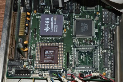

Hi,
I'm trying to locate the proper jumper settings for my particular motherboard revision and having a heck of a time. It's an Opti 495SLC 3/486 board marked Rev. B and none of the documentation I can find online has the jumpers in the right place to match my board.
The BIOS string is 40-040B-001117-00101111-080893-OP495SLC-F.
I'm trying to put a 486DX2-66 in place of the TI/Cyrix 486DLC and 487 that are currently installed. I just don't want to break anything.
The clock is currently set at 33MHz despite the fact that my 486DLC seems to be a 40MHz chip.
Thanks for any and all help.

Chupperson wrote:
Hi,
http://www.kva.kursk.ru/bios1/numbersami.shtml
That 1117 indicates it's an A-Trend board.
Googling the OP495SLC-F dug this up:
http://www.elhvb.com/webhq/models/486vlb2/opti495slc.htm
That looks like your board:
If so, the .zip file on that web site contains some .pcx image files (retro indeed 😜 ) with the relevant settings.
Possibly it's misconfigured (maybe the DLC was an upgrade from a 33MHz part and the previous owner messed up the jumper settings), or perhaps the VLB cards didn't like a 40MHz bus speed and needed 33MHz to be stable.
In any event, this is an interesting board, that's a socket that can accept either 386 or 486 CPUs (the 486DLC is technically a very advanced 386, not a 486 clone). Most important thing to get right is the orientation of the CPU. There's no keying on the socket so you can physically put it in any way. Only one out of four will work and there's a good chance the other three will let out the magic smoke...
Edit: nope, now I look better at the picture it's very similar, but not the same, and the jumpers look different. Sorry 😢

Chupperson wrote:
Hi, I'm trying to locate the proper jumper settings for my particular motherboard revision and having a heck of a time. It's an […]
Hi,
Post a full picture of your motherboard - just so that we can be sure (I noticed a small difference of your board in the lower left corner, compared to the one that dionb posted.
However, the one that dionb posted was also manufactured by DataExpert (model EXP3406).

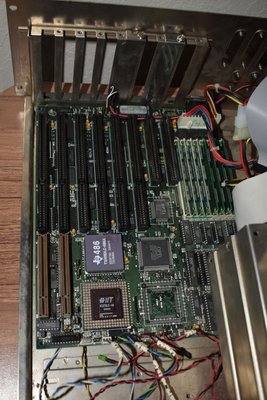

Reply 3 of 19, by Chupperson
Thanks.
I found those PCX files as well. That board is nearly the same as mine except the jumpers are all in different places.
I didn't want to take the board completely out of the case unless I need to, so let me know if seeing the other part is of any use.

Reply 4 of 19, by Chupperson
I think I found it!
It's "unidentified" according to this site.
http://stason.org/TULARC/pc/motherboards/U/UN … -BUS-3-486.html
The amount of slots is correct and the jumper numbers all seem to correspond...
Reply 5 of 19, by jesolo
Yes, I think you've got it - here's a better link: http://arvutimuuseum.ee/th99/m/U-Z/32085.htm
See if you can get a VESA Local Bus graphics card to work with your Cyrix CPU.
I sent you a PM as well.
