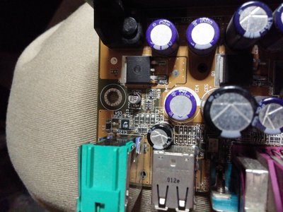

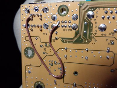

I recently came into possession of a really fantastic piece of a gear from the time when I was really starting to dive into building and upgrading PCs myself. It's a historically significant CPU from the year 2000 in a very nice motherboard. It all looks to be in great shape except someone at some point did some kind of oddball modification to the PS\2 port and USB port wiring. I probed the connectors with my multimeter to check which pins these are, and if I'm reading the pinouts correctly they've simply connected the +5v pin from the PS/2 KB\M ports to the +5v pin of the USB ports.
What exactly would this DO? What would it accomplish? Is there any likelihood of damage?
All I can guess is either they had no power on the PS/2 ports due to a defect or they were trying to get additional power for some kind of external device (KVM, etc.) that ran off of the PS/2 ports... but I have no clue if that even makes any sense.
It looks like they also dismantled the PS/2 port casing... again, no idea why.
It is an Asus K7V motherboard, and I'd be very surprised if the board wasn't at least turned on like this at some point, so I doubt I'd be doing further damage by running it... but I haven't tested it yet because the only CPU I have to test with is one I don't want to risk damaging.
Anyone have any ideas? Ideally I'd like to get rid of the wire and have the board looking normal again. I have plenty boards I can harvest replacement PS/2 ports (or at least the metal cover) from if necessary.

Check continuity across that green "P110" SMD. It's a fuse. Perhaps they wanted to bypass it to allow more current to something. Maybe it was done that way after it blew and never reset. The PS/2 port looks barely soldered in there, almost like you could yank it out. Maybe some other kind of mini-din connector (they're prevalent enough) got plugged in which didn't belong there. "It's got S-Video!" So the jack was probably replaced.
I also see "FUSE2" silk screened near the COM1 label. Check and see if that one is not open as well.

Fuse1 (P 110) and Fuse2 (the small white rectanglular bit?) both are open when I do a continuity test. There is also continuity between the fuses and the +5v pin in the mouse port (figured it was worth it to test that too).
I actually took the rest of the pieces off of the PS/2 port since the remaining sleeve wasn't even soldered on (as you mentioned). All of the pins inside look fine. This is the first time I've ever seen the inside of a PS/2 port. They certainly don't look the way I'd expected. Its interesting to think that you can probably swap the different colored ports from other boards since the plastic casings slide free from the pins and hook together like puzzle pieces.
Anyway... I wish I had more knowledge of circuits. I'm sure I could follow these to some point where it would either reveal if there was a problem or not.

So, I figured I'd never know what exactly was going on with that wire in place, so I just tugged on it a little and it came loose easily. :p
EDIT: I was misreading something. I'll keep investigating this before posting any more wrong stuff. 🤣
When I check resistance between the +5v pin on the PS/2 connector and the +5v on the ATX socket, it showed some resistance but it kind of bounces around between 3.5 and 1.8 Kohm. Seems to be connected? I think I can probably try it this way without the wire in place, and see what's going on.

Looks like some sort of fix of the PS/2 ports. Maybe there was physical damage and they replaced the ports? Looks like they were resoldered on (not very well as you and others also noticed).
I assume you checked, but the way the wire is attached to the board it's bare wires are (almost?) touching other solder points.

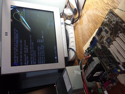

The wire was close to touching one other solder point but it was also a +5v. I have removed the wire since there does seem to be some connection to the +5v on the PS2 ports without it. I powered up the board with no CPU and it didn't catch on fire, so I installed the CPU and tried it. The system seems to work fine with a USB keyboard but I cannot get a PS/2 keyboard to work (not sure about PS/2 mouse yet as I don't have an OS installed).
I have a bad feeling that something worse than a single SMD component is at fault here. Where would the keyboard controller be on a KX133 board? I'm assuming it'd be in the chipset, not some separate component.
Reading online I'm seeing a few complaints of bad PS/2 ports from this era, and one from this same board.
Anyway, here's a picture to show why I care about fixing this...
3.61 MiB
295 views
Using a USB keyboard seems to work for most things, including DOS, but if there's an issue with a USB driver in Windows 98 I'm kind of stuck. It seems like the PS/2 mouse port is also dead. Anyone have experience diagnosing problems like this? It doesn't really seem like a power issue, it seems more likely that they tried to run the +5v and it didn't work so they never bothered putting it all back together.
