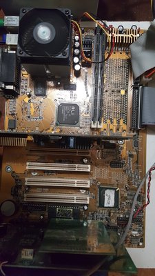

Well I received the motherboard yesterday after playing with it for quite awhile I got it all up and running
I'm still waiting on my cpu k6-3 but for now I'm playing with an old Intel 233mmx and seems very stable at 300mhz 2.9 volts is all
The only thing that make me a bit nervous is a transistor that seems to get pretty warm and biostar put a pretty big heat sink on it I may just throw a small fan on it and call it good
Reply 3 of 7, by shamino
I'm not familiar with that board but the hot component might be an onboard regulator for the +3.3V supply. From what I searched I see that's an ATX board, and ATX does provide a 3.3v rail at the power connector, but some boards still preferred to have their own onboard regulator for that voltage.
I don't know if they had any reliability issues on that board, but it wouldn't hurt to keep it cool, especially if you'll be installing a higher powered 3D accelerator.
Reply 4 of 7, by kd0kqq
I think you are probably right I did put a small fan on it last night just for piece of mind and I am using a GeForce2 mx400 video card for now until I can find a voodoo3 for the right price I will try to upload some photos of it later

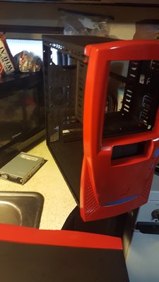

Here is a few pictures it's know where near done but it's a start
Reply 6 of 7, by kd0kqq
Well my build is all done I put a k6-2+ 500 clocked to 550, 256mb ram, a late awe 32 basically a awe 64 with ram and last a geforce3 ti 200 until I get my hands on the right prices voodoo 3 all in all I got this built for a little over a $100 and it plays most games pretty decent for the 90s that is.
