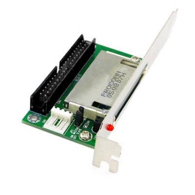

What does your CF to IDE adapter look like?
Reply 4 of 11, by anetanel
Pretty sure it is this one:
57.45 KiB
2068 views
