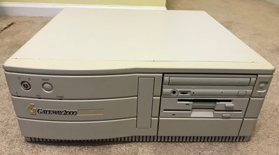

Reply 4 of 7, by Katmai500
Love those old Gateway towers! Awesome that you still have your own. It looks to be in excellent condition, too.
I actually just ordered a Syba SD-CF-IDE-A IDE to Compact Flash Adapter and a 4GB Transcend 300x Industrial UDMA CF card to try in the baby brother of your tower, a 4DX2-66V Desktop. Mine doesn't have the promise IDE card, so I'll be trying it with the onboard IDE controller. I'll post an update on how it handles the 4GB card.
