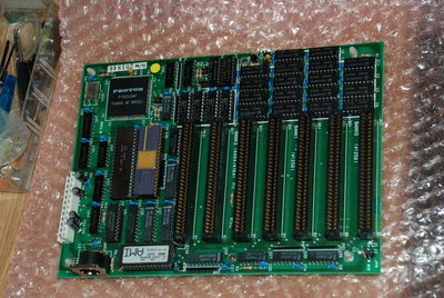

Hi,
i got this nice little XT Mainboard, but i can't figure out what type it is.
Anyone has Information on this one ?
i wanted to know howto switch the damn Turbo.
Its running on 4,77Mhz but can also run at 8Mhz.
Common key strokes strg + shift + + and so on don't work.
The two Pinheaders near RAM (Yellow cap) are PC-Speaker and Reset.
Thanks
Matthias
143.51 KiB
851 views

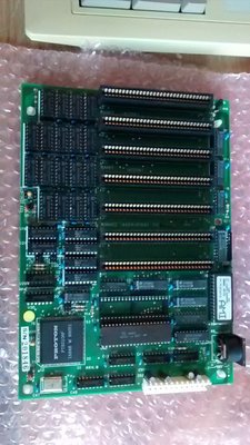

Still no success.
I have made a better Picture.
549.41 KiB
791 views
Anyone knows howto activate Turbo Mode ?
Thanks
Matthias
Reply 2 of 12, by derSammler
Common hot keys are probably not working because this one has an AMI BIOS. Turbo XT boards normally came with some obscure / hacked custom BIOSes. What make you think this is a Turbo XT after all? The fact that the CPU is rated for 8 MHz doesn't mean that the board can do anything else than 4.77 MHz. I don't see any signs for switchable speed on that board.
Reply 3 of 12, by alvaro84
I think it "must" be a Turbo board because it's so small and highly integrated.
I also think I'd bite the bullet and try putting jumpers on the remaining unknown headers while running a realtime benchmark like Landmark 2.0. It worked for me so far, I didn't fry anything.
Reply 6 of 12, by carlostex
Try to use this BIOS instead:
http://www.phatcode.net/downloads.php?id=101
I believe this BIOS has shortcuts for Turbo ON/OFF.
Not to brag but the ROM expansion between F000h to FE00h was my idea. I pitched this idea to Plasma to allow users to use the ROM BASIC socket for expansion ROMS too. Usually BIOSes stop looking for expansion ROM before F000h or F200h, so that would negate using the ROM BASIC socket that starts at F600h. But you can still use the socket for ROM BASIC.
I would recommend to everyone using an XT to try this BIOS, Plasma has done a marvellous job with it.
Reply 7 of 12, by matze79
Yeah but it only detects 512Kb on my Board, Turbo is enabled with it even 9,54Mhz.
I really need 640Kb 😀

Reply 9 of 12, by Plasma
This is odd, because the memory size is determined by a pattern write/read test. You can "force" 640K by changing line 545 from "add bh, 4" to "mov bh, 0A0h". But be prepared for Bad Things (tm).
