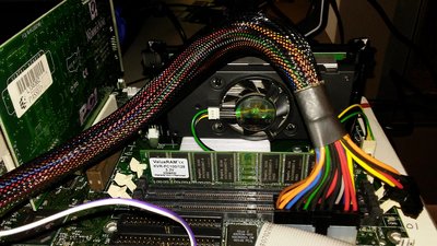

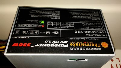

Ok went and tried everything I know of to this point and still nothing. I'm attaching some pics of the power supply & ram in case someone out there sees something in the ratings that could be the problem. Any comments would be appreciated, thanks!
    932.91 KiB
    746 views
The DIMM there has Hynix chips with HY57V28820HCT-H. You can look up what that means here. Long story short: those are 16Mx8 chips, so perfectly compatible with the i440BX. The PSU is overkill for a system like this, and does not supply -5V, so some ISA cards might nto work, but if it is in good working order it would be fine for the system in this configuration.
But...
To be sure you need to check the individual compontents on a different system. Only once they're known good can you rule them out as the cause of your problems here.
