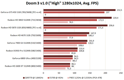

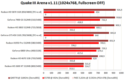

Why would you want to use Windows Vista/7 for AGP GPU testing, when 95% of them can't even run DirectX 10 games with proper speed ?
I tested Quake III Arena and Doom 3 along side 3DMark 99-2006, but I guess you missed that part...
Well, here's table with results for two other games.
27.62 KiB
601 views
25.74 KiB
601 views
Pentium 4 (in Pink) can't handle Quake III Arena or Doom 3 with anything faster than X1950 Pro/7900 GS (it's simply too slow).
Also, in both games ATI drivers have higher CPU load (at least for fastest DX10 cabable models), that's why (with PGA 478), X1950 Pro can win against (in theory) newer and more powerful cousins.

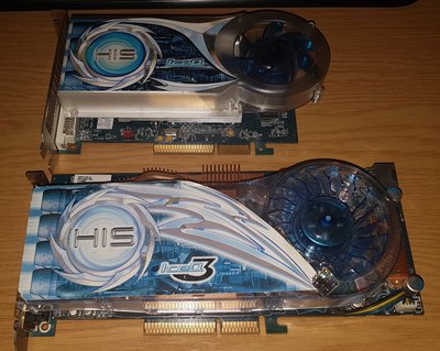

@Tetrium : I own both 4670 and 3850 in IceQ variants (4670 model has 1GB VRAM 1600MHz DDR3) 😀

EDIT :
@meljor
PCI-e version of 4670 has 2000MHz (effective) RAM speed, and even my IceQ has "only" 1600MHz.
On top of that, GPU Core clock is 20MHz higher on PCI-e edition - at least from TPU test (my card has Core Clock of 750MHz.
For HD 3850 situation is inverted. My card is a overclocked version of PCI-e one (670MHz vs. 715MHz on my, and 1600MHz [effective] VRAM clock vs. 1818MHz on my IceQ).
I didn't underclock my 3850 to stock, because getting 4670 AGP with 1GB DDR3 memory isn't easy, and most 4670s for AGP has DDR2 memory instead of (G)DDR3 (which makes them A LOT worse for gaming).

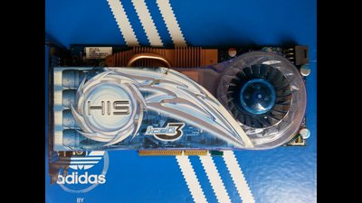

Everyone knows that most of AGP based systems, MB/CPU will be not able to use even an x1950 Pro AGP to its full potential. The thing here is only about the 2 cards, bcuz i have seen many people to talk that HD4670 is the fastest card, while it is not, and the HD3850 is the fastest AGP card, it was about that.

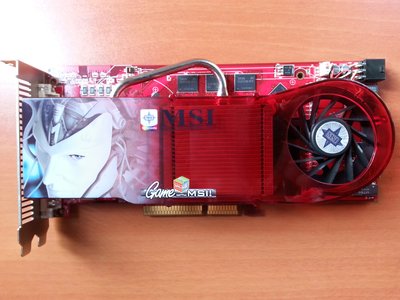

HIS cards seems to be one of the best build out there, also MSI on x1950 Pro is very well made, while Sapphire is lacking things, and the cooler is total trash...
Agent 007 seems you have the best cards from HIS nice, as i see them to be the better ones, too bad i did lost my chance to buy HIS HD4670 AGP...
And this is the MSI card...

Crysis uses mostly DX9(c) code, only in Very High quality setting you get some DX10 effects.
However, you want to tell me a OC'ed HD 3850 or HD 4670 can run Crysis in DX10 mode on Windows Vista/7 ?
Here's anadtech test for you : LINK, take a look at what HD 3870 scores. They didn't even used Very High Preset, they only used High Quality Preset and changed Shaders to Very HIgh quality.
Personally, I don't see the point of testing graphics setting you can't enjoy playing at.

What I meant by "isn't easy to get" is pricing and availability : LINK <= This is my card (1GB DDR3 1600MHz). Who spends that much $ on a AGP GPU ?
I bought my card few years back locally for ~70$ (that's with with shipping).
Does your Club3D have VRAM clocked at 1333MHz ?
EDIT : Here's ASUS version of 4670 1GB AGP, with DDR2 memory : LINK
