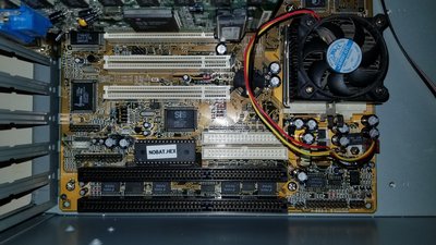

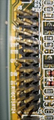

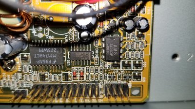

Hi, I have an Amptron Socket7 PM-9100LMR motherboard. However, I do not have the manual and I cannot seem to find one online.
I am trying to hook up the power button, reset switch, hard drive led, etc. However, the motherboard does not mark these connections like a modern motherboard.
I assume that the connectors are the group in the bottom right corner of the board, but I am not sure.
Does anyone have this manual or can you tell me what goes where? Thanks.

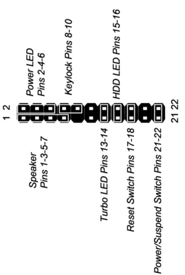

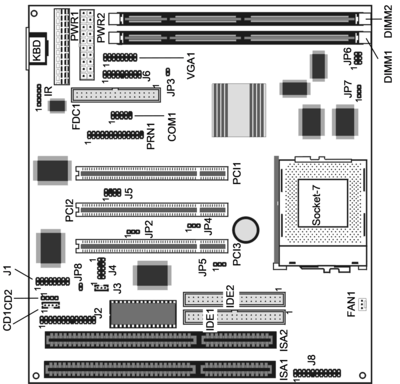

Amptron are rebranded PcChips motherboards. The layout of your motherboard looks identical -at least for the part you're showing us- to PcChips M571LMR.
It also has a 22-pin jumper array labeled J8, with pin 9 missing.
853.39 KiB
357 views
Manual extract for (J8):
54.25 KiB
357 views
Needless to say that you're doing it on your own and please don't blame me in case of fireworks. I would definitely try this legend and I'm personally convinced it's correct, but I had to say this 😉
