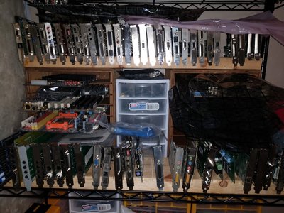

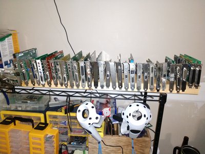

I can't recall ever having been shocked by touching a wooden material, and wooden combs are used to eliminate static when combing hair.
I picked out a nice, dry untreated 2x6 board and cut a series of slots across it with a 2mm thick saw blade as a temporary card storage rack.
Any educated opinions on whether this is a sane way of holding ISA cards between projects?
Any semi-educated or outright un-educated opinions?
I am going to cut some 30-degree angled slots in another board and see if it would work wall-mounted.

Should be just fine. Wood is not a conductor of electricity nor will it pick up a static charge.

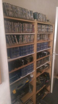

Reply 14 of 20, by meljor
I have been storing my agp, pci , isa and vlb cards for a couple of years exactly the same way, never had a problem.
Easy to grab one so great for testing, and saves space.

Reply 17 of 20, by keenerb
What I ended up settling with. It's aesthetically pleasing in my opinion. Room for 60 cards or so and a dozen motherboards.
I'm replacing the white plastic shelves with a support block and use the middle section for my longer stuff like AWE32, Intel Aboveboards, and a few full-length single board computers.

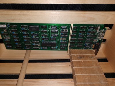

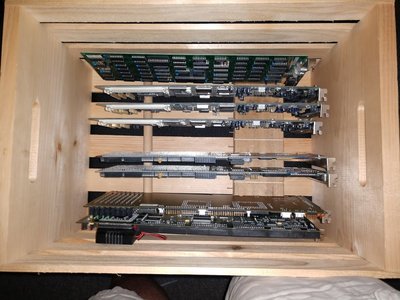

Reply 19 of 20, by keenerb
I picked up a wooden crate at a local Home Depot to do something for longer cards. I used a 2x4 block with a 2mm cut, and ran a dowel across the back to support the rear of the cards.
You can see some small nails I placed between each slot, to use to secure the cards with possibly rubber bands.
Not at all sure if this is really superior to "rubbermaid container full of antistatic bags" but I do feel like the cards themselves will avoid any incidental damage from knocking against each other.
