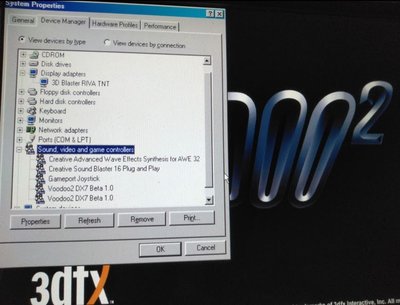

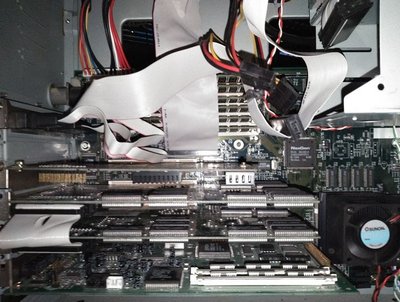

Well I finally got it done. It's been on and off again.
I went though (12) PCI video cards to find one that would work.
Ether it wouldn't post, beep at me, lock up, or drivers were to new for the PF110.
I settled on a Creative CT6700 Riva TNT 16MB for the primary.
Dual matching Voodoo2's 12MB
And a AWE32 with two 1MB simms.
Loaded on a 8GB Compact Flash from Sandisk.
For now she's complete. The NexGen PF110 Voodoo2 SLi rig.

Reply 36 of 80, by The Serpent Rider
Everything up to GeForce 4 MX (or Quadro counterpart) should work too.
Reply 37 of 80, by thehinac
Actually the Geforce FX5200 256MB PNY branded, worked perfect until I tried loading the latest drivers. Up tell that point it had no issues.
Well after a quick check the same drivers that worked for Riva TNT have support for the FX5200 also. So I'll pop it in and check it out.
I would have never opened the INF file if you wouldn't have talked about the 4 MX. Thanks man. 😁

Gotcha, hmmm... Even at 800x600 I feel I'd be more bus/cpu bound than GPU. Like it wouldn't at some point. But that would take some testing.
Do you have any photos of your rig? I'd love to see the inside of your build!
