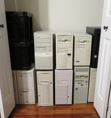

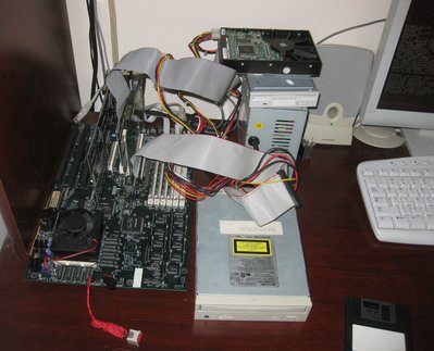

I haven't really done any official system build threads. I looked through my computer images folder and this is what I've got.
An image when the board was on the testbed, and another with it residing in the computer closet with 17 other cases (not all 17 are visible in the photo). The NexGen case is the one with the NexGen badge on the top right.

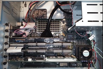

Yeah! that's awesome. I tried a updated pata card but it won't load the rom for me so i could boot from it, but yeah it would be good for storage.
I'm using a IDE to Compact Flash adapter. It works great, really zippy. Plus I was going to make a Windows 95 load too, so I can switch between 98 and 95 really easy. The Sandisk compact flash support max options the motherboard has so it's not so bad. Wish there was one more pci slot though. UDMA7 compact flash would have been awesome.

Reply 42 of 80, by thehinac
But to get the compact flash to work right was very interesting mashup operation.
Onboard detection doesn't work correctly to read the card's internal specs, and the dos utilities that come with the Nexgen 3.1 pack don't read correctly ether.
So you have to plug it in to a newer system's usb CF reader, I used Windows 7 then use msinfo32.exe to read the disk info. Regardless of the CF card Heads is always 255, and Sector is always 63. You just need the Cylinder number for Cylinder and LZ which are the same number. Then manually punch in the bios.
After I used Windows 7 Diskpart's clean command to wipe the partition info, then make a new primary. When I tried to use the Windows 98 boot disk to use fdisk I'd have drive problems later on during the setup of Windows 98.
Next I used format command from the windows 98 CD to format the drive. If I used Windows 7 I'd have drive problems later on during the setup of Windows 98.
It was just a bunch of trial and error putting something on something that wasn't designed for it. Hope this info is useful.

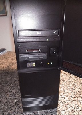

I noticed your case displays 110. Normally, people setup the actual CPU speed onto the case display. Not sure if this was intentional or not. It runs at 102 MHz.
Reply 44 of 80, by thehinac
It's just a badge to me, to signify PF110. Know it's not the actual Mhz rating. I was only pulling like 101Mhz on tests.

Did you make that NexGen badge or find a new old stock original? I just ordered a 3DFX square badge for this case. There is a square indention on the lower of the front panel for one, thought it would be a cool estetic.

I made the NexGen badge on that particular case as the indention is non-standard. Just used a standard B&W laser printer, cut it out, then used some ultra clear boxing tape to protect the print and give it some gloss. Then doubled sided tape to attach the badge to the case. I sort of recall there being someone on eBay or in the forums who makes or orders custom badges though.

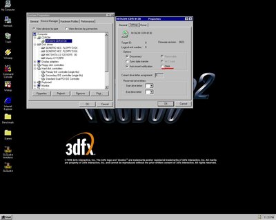

Does IDE DMA work? I use the CD-ROM on the onboard IDE port so that I have DOS access and when in Windows, I don't recall if there is the DMA check box option under the CD-ROM. I thought not, but I'll have to check.
EDIT: What happens when you put a check mark in DMA for the CD-ROM then reboot? Think back now, I recall doing this, rebooting, but the DMA check box disappeared. What date do your IDE drivers have? Mine 6-30-2001. I'm not sure where they are from.

driver is 1999. DMA stays on for both HD and DVDrom after reboot. DTCSPEED.exe is about 14,500k dos, and under a windows dosprmpt 13,500k
