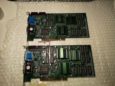

Well. Bad news. Turns out none of my 3dfx cards work. 2 had physical damage. 3rd works for about 3-5 seconds before crapping out. So I just ordered a pair of what I believe to be the best voodoo2's off ebay.com. See graphic. This build is already basically Jurassic Park "Spared no expense" So oh well. Be back in a month when I get them.

110 MHz. interesting. I think mine only read 100 MHz.
I haven't seen these come with the heatsinks like this. Which manufacturer did this?
I have a dead Diamond Voodoo2 which doesn't work at all, and one STB Voodoo2 which works for 20-60 minutes, then stops working. Then next day works again. Probably a bad solder joint somewhere. Seems like there's a lot of dead Voodoo2's. Has anyone determined if there is any commonality to these failures?
Reply 62 of 80, by The Serpent Rider
Gainward Dragon. 110mhz memory does not guarantee that chips will work on such high frequency, even with sufficient cooling.
Reply 63 of 80, by matze79
And AT Cases are not ventilated that well too...
Reply 64 of 80, by thehinac
The 3 cards I'm using I got one to work last night after cleaning and pin bending.
I originally got them from a big box of pci/agp cards that where not in static bags. That had been through two moves. Before I got them. So think worst conditions.
Yeah no reason the ram couldn't be down clocked. guess I'll run some old gpu tests on them when they come in and post up the results. They might turn out to be crap, and I got jipped. I'll wait and see. Hey stop killing my unfounded happiness mixed with buyers remorse dang it. 🤣. If I was working on facts and logic I wouldn't have started down this road. hahaha

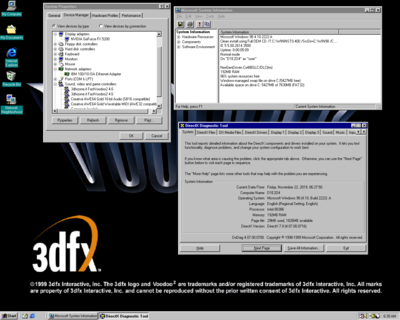

Reply 74 of 80, by thehinac
Well it's finally done. Though not completely happy with the NxBus through put at the moment, because of the inability to run bus sync mode to the cpu frequency. And the known mouse issue. But over all the system is functional, games work, SLi works, D3D works, Network works, Compact Flash is transferring at max speed of the onboard IDE, Sound from the AWE64 Gold works. No lockups or malfunctions in relations to Windows 98 itself or the motherboard.
I'm still working on over all CPU/Bus speed by replacing the onboard L2 Cache of the motherboard itself. Which has been done before, but I haven't see it done to a NexGen PCI motherboard as of yet, only the NexGen VLB version. If it has I haven't see photos of a cache modded NexGen PCI version.
You can follow the progress here and find info about this process and tips here;
http://www.cpu-world.com/forum/viewtopic.php?p=259471
This thread should have all related information, and links to previous works of hard working users that this process originaly came from.
I plan on making a new thread later showing all drivers, softwares, and hardware used. In hopes future people working on this can skip some of the hard work and move right to playing games and testing on future builds. I'll post on this thread when I do.
